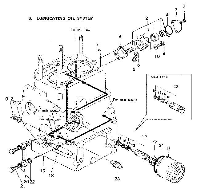

Where is oil pump on YM165? I don't have a parts manual yet and the owners manual seems to show that you get at it from the Flywheel housing. Does this mean I have to completly remove the motor to access the oil pump?
   / Where is oil pump on YM165? #2
Most models I'm familiar with are located behind the timing case cover.
It's not too difficult to remove and nearly certain that your model does not require engine removal.
I can't imagine accessing the oil pump from the flywheel side, usually it requires removal of the radiator, crank pulley (And Key), water and FI pump and front engine case cover. With the cover removed, you'll see three large gears (crank, cam and oil pump),
Mark
   / Where is oil pump on YM165? #3
The tractor will have to be separated and the flywheel removed.
Danny
   / Where is oil pump on YM165? #4
Danny
Holy Cow! Thanks for fixing my bad advice...didn't know that model had to be split.

If it were mine, I would put it back together, fill the filter with oil, try it and see if I get oil pressure.

Engine Oil Pump I did find a schematic of it here "http://partsandservice.ca/bin/ipl.cgi"
And I do need to seperate the gear case from the engine which involves removing the engine. I think I will take Normde advice and put it back together and try the oil in the fileter trick.

I have the head off and I can see some oil flowing next to the rocker arm supports, so I think my engine oil pump is working I just needs primed. I will do as you say. And try that. My only concern is that I have removed the Engine oil check valve ( the part that the oil filter screws into) and their is no oil flowing behind it.
Here is the pic of the engine oil lubrication.
