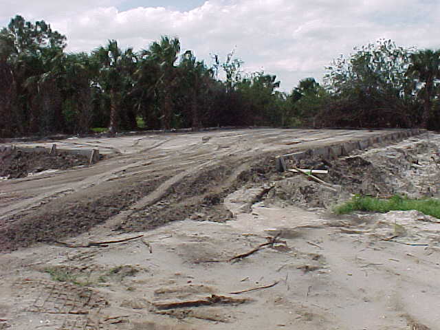

I looked as well and bought a steel "arch style" building....It looked like the best deal for the money....
Mine is 40' x 80' x 18'.......1 wall with "aircraft hangar doors" the other has 12' x 12' roll up with a service entry door...
cost for building being about $23,000 delivered......add $13,000 for the monolithic cement slab and $8 to $9k for labor and equipment to put it together bringing the total to $45,000. For Florida thats about the best I can do....
See my other posts and you will see my "project" in progress....
The slab is framed and inspected and will be poured next week....
I'm not expert by any means...just thought I'd add my 2 cents........
