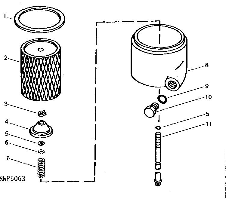

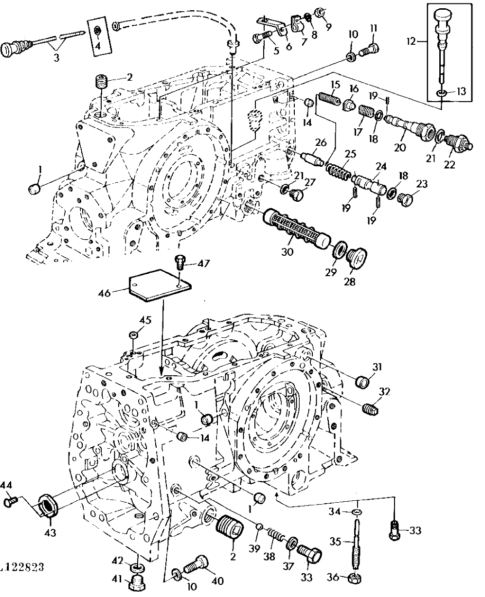

Where is the filter for hydraulic/transmission fluid on 2640 1980 year model ?
I was told to remove a bolt under right side.
I read online to drain Trans fluid then clean a screen you get to after removing a 1/2" plug.
A diagram would be appreciated.
Thanks.
   / Where is the filter for hydraulic/transmission fluid on 2640 1980 year model #2
Hyd filter from JD AR75603 Filter Element ADD 7.96 USD
Trans screen is parts key #30. Hyd filter bolts up at the bulge in trans case between parts keys #26 & 27(1st photo)
