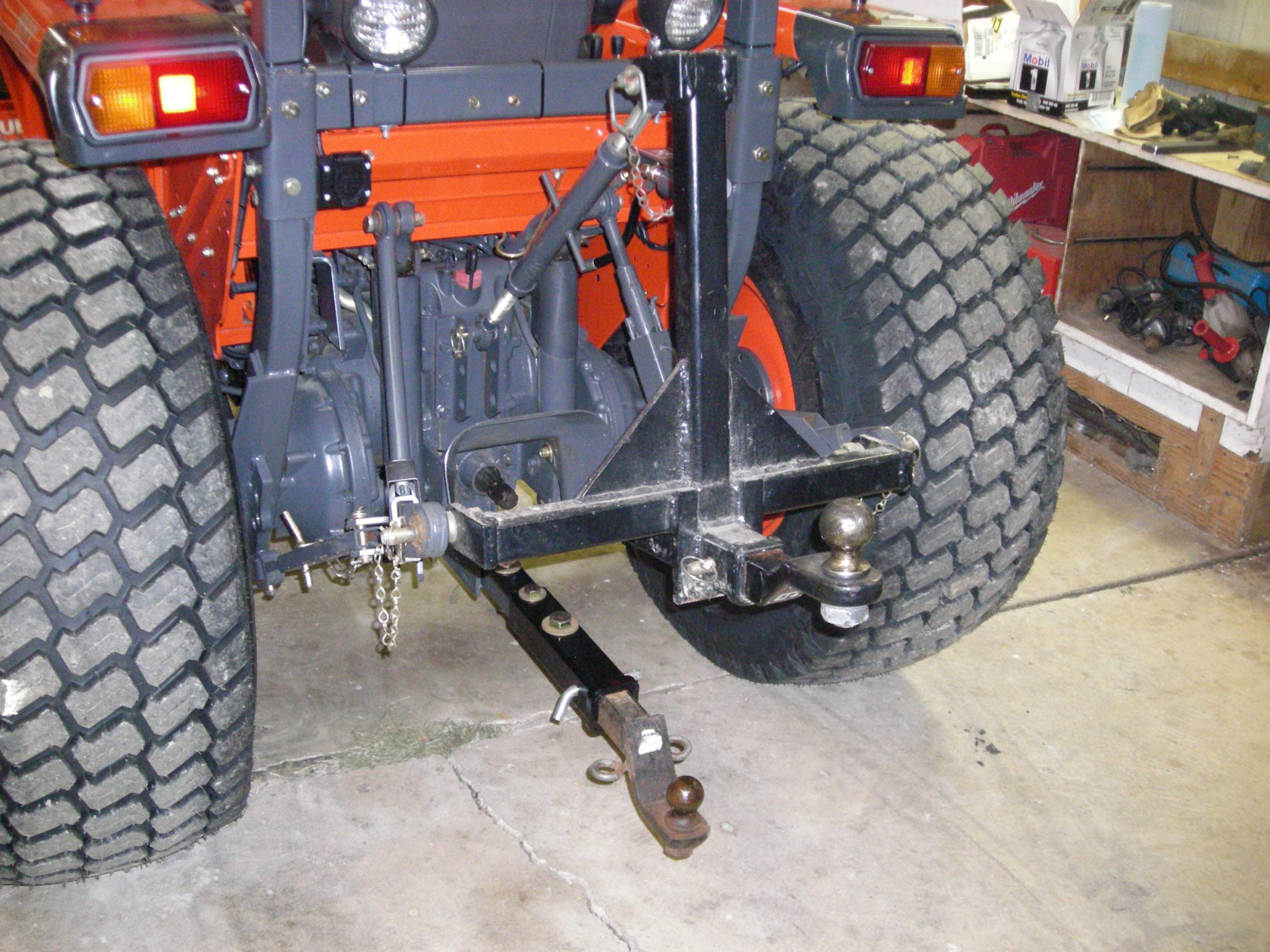

While I await the arrival of my owners manual and service manual I want to check the hydraulic fluid level in my L4310. I can't find a sight glass or a dipstick. I ran a clean rod down in the hole where the fluid is added and don't get anything on the rod. The hydraulics/hydrostatics work fine, but I just am not comfortable running a used machine unless I know all the fluids are adequate. Sorry for such a dumb question, but I can't find the answer anywhere on the web. Seems other models have a dipstick right behind the fill hole or a sight glass in the back, but not this one. Thanks

My hydraulic level dip stick is directly to the left of the red fill cap you see in the picture. Different tractor though. Philip.
   / Where is the sight glass or dipstick on L4310? #3
Should be a sight glass about even with rear axle on left side looking at the back of tractor.
   / Where is the sight glass or dipstick on L4310? #4
I have a Kubota L4400. When facing the rear,the sight glass on my model is on the left side of the PTO shaft and cover. The fluid inlet is situated directly above the Top link.
Thank you kindly. You are both right. I was sure looking for something more substantial than a tiny round plastic dot. Never-the-less, I found it and thank you very much.
