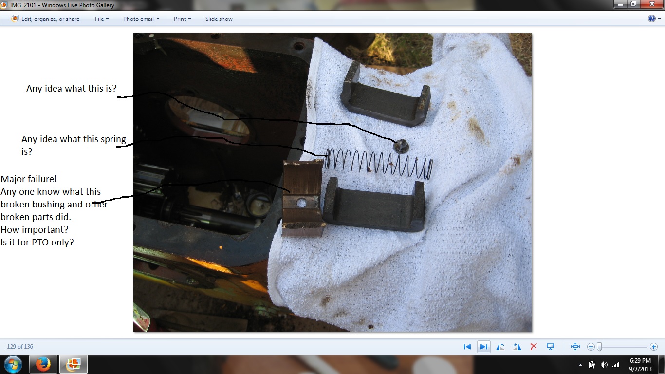

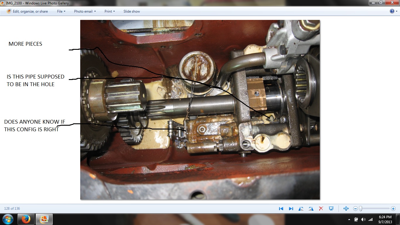

So I found a new cylinder off Ebay. Installed it and found one stripped hole. (feel that was why it broke). Got it back together and tested it with wheels off the ground. Feel like its working but when driving it, it's really a bear when going slow!.
So I went to test the lift, no go. Took the cover off (by unbolting dashpot) and found numerous pieces of the pump all over the case. Also found a light spring (see pictures).
I found a new pump off ebay. Will be installing it this weekend.
I have 2 questions 1. Does anyone know what this spring goes to?
2. Is it appropriate to remove and reinstall the cover by unbolting the dashpot, or is there a better way?

Good Morning Gary,
I have a 64 Super 90WR and the innards are similar. The pump is shot. The first picture is mostly the pump "pistons" and in the second there should be NO scraps, floaties or anything else but fluid in there. so defintely a pump is in order. The 90 I have has a seperate pump on the R/H side of the case which runs the P/S not sure about the 135. Usally the O ring is cracked or messed up and the fluid that powers the steering leaks past that under load, but that's an easy fix. I would first see if I could find a shop manual, really worth their weight in gold! Also the folks here are great and always have a wealth of helpful info and experience. BTW welcome to the forum.
