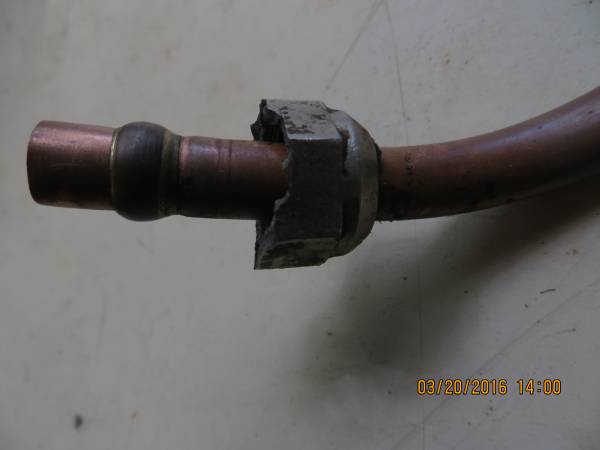

On my cheap-o Harbor Freight air compressor, a compression nut broke on the tubing that runs from the compressor to the tank. This appears to be 10 mm copper tubing and I need to get a female compression nut and ferrule.
I have found distributors that sell them by the thousand but can't find any places that sell just one.

Try britishmetrics.com. They're in Maryland.
   / Where to buy a metric fitting. #4
As you are seeking a compression fitting, does it have to be metric? I would think a sterling measurement fitting would work fine, as you are tightening it for effect.
Fastenal doesn't sell them. British Metrics wants $20 plus shipping but they are out of stock and may be about a month or so. The female compression fitting has to screw unto the male compression fitting in the tank so I can't use something with different threads.
$25 seems like a lot to pay for a nut for a $99 air compressor. I think I will try to silver solder the tubing to the fitting.

The answer is ALWAYS McMastre-Carr. McMaster-Carr I haven't looked, but they have it. They will deal with individuals (unlike Grainger) and they stock everything. Shipping is fast and fairly priced, but their prices are not low...

Does the fitting in the compressor unscrew? Maybe you can replace the complete fitting ....Mike
