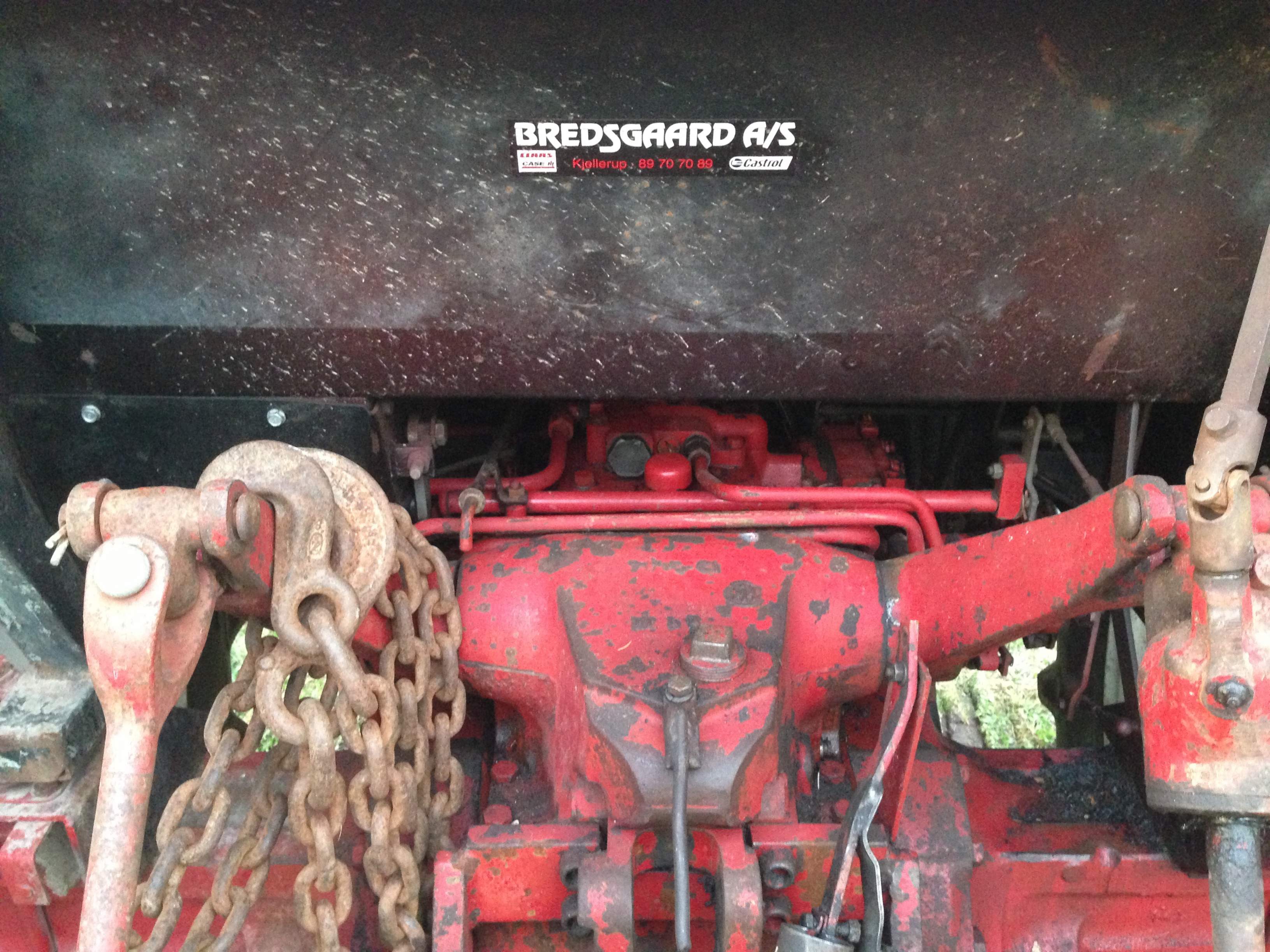

Hey
I can't find anything in the forum saying where to fill hytran fluid on my ih 784.
And where do i check the level of fluid?
I've attached a photo from behind the seat as i may think the stick is the one on the left? Am i right?
And do i fill the fluid in somewhere here too?
Thank you in advance . :)
   / Where to fill hydraulic fluid on ih 784 #2
The large fitting, right beside of the top link keeper.

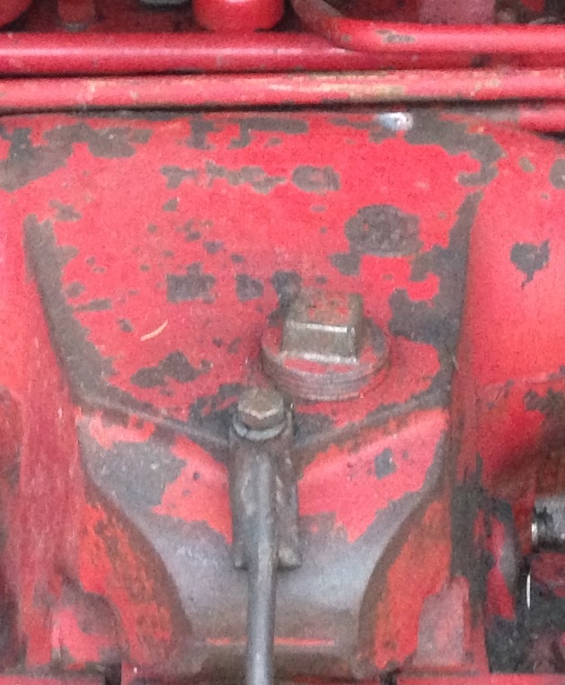

You mean this?
And do you know if the stick on the left is where to check the current level?
If it is, i think it's totally empty as nothimg shows on the stick. :-S
   / Where to fill hydraulic fluid on ih 784 #4
That's it!
I doubt it is completely empty.
   / Where to fill hydraulic fluid on ih 784 #6
The square plug is where you put hydraulic/transmission fluid in. I own a 684 and the dipstick is located by your heel on the left side of the tractor when you are on the seat.
