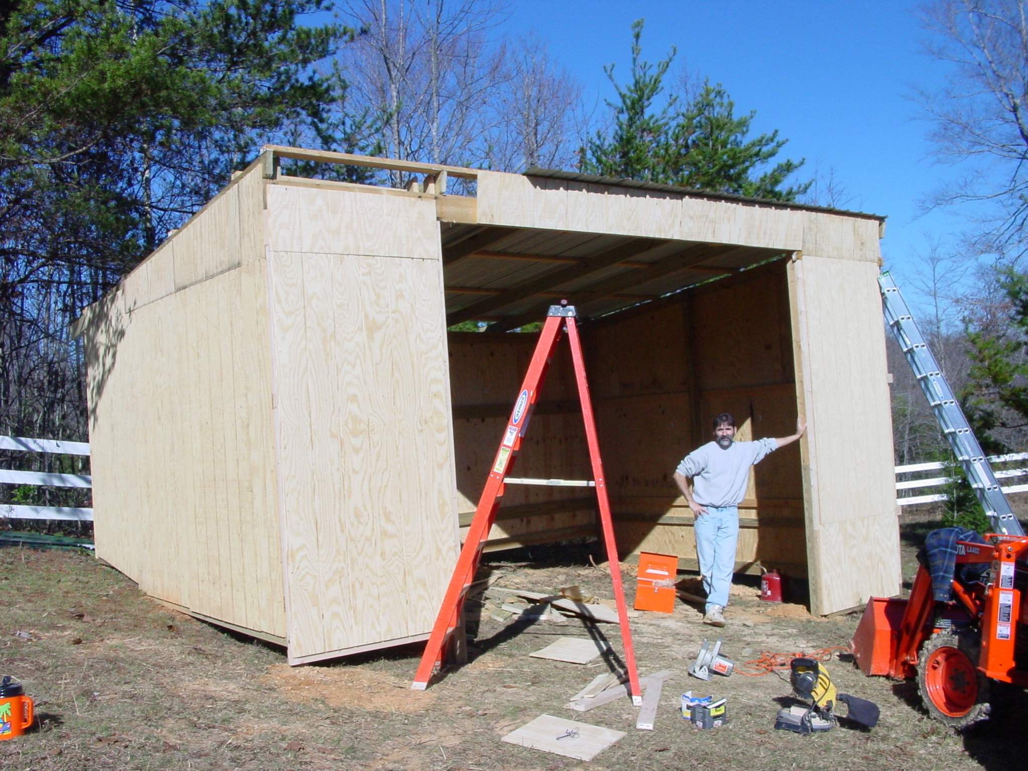

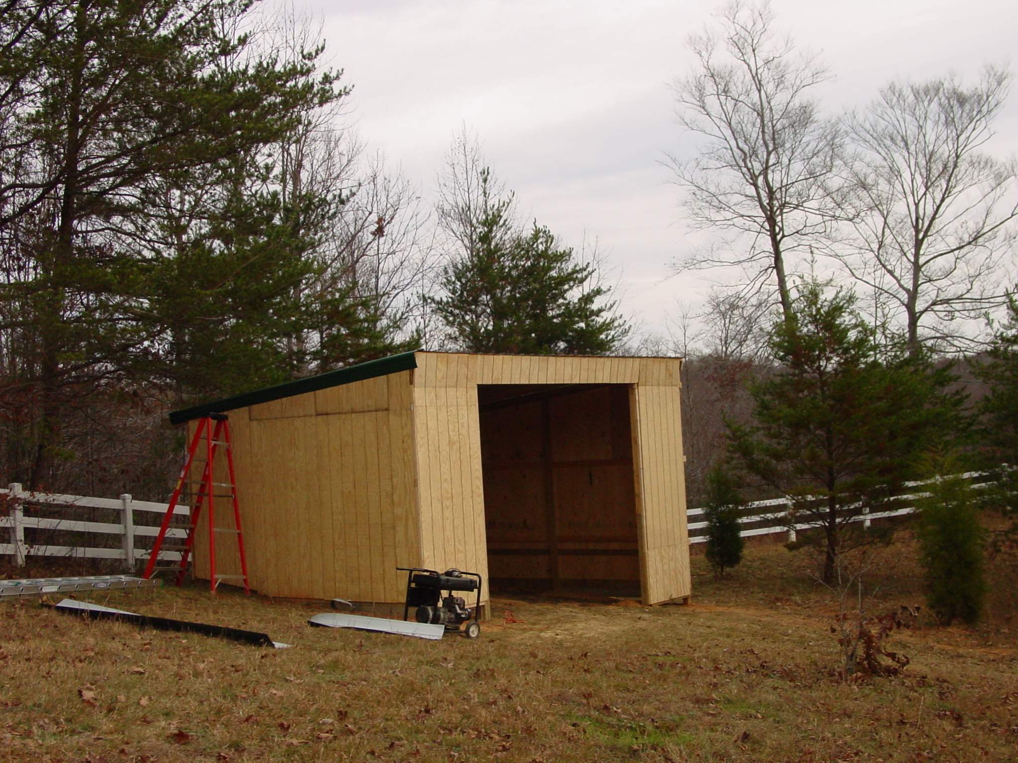

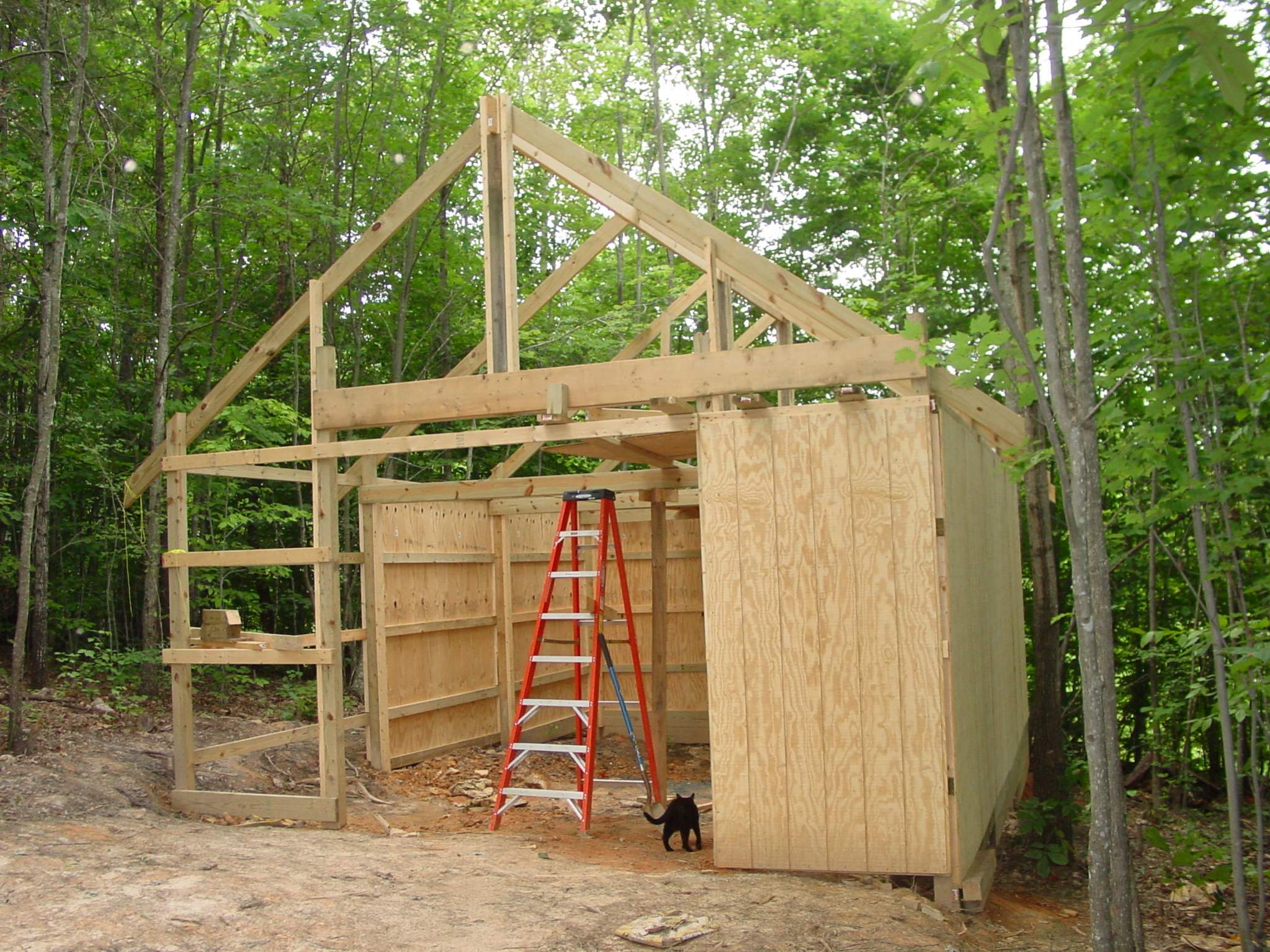

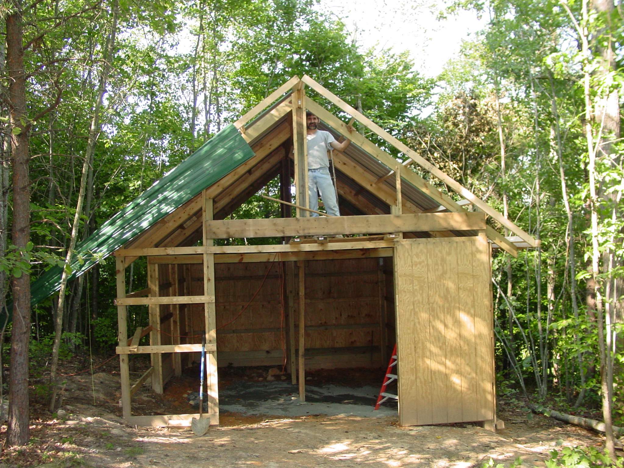

I have done my own sheds four or five times. No plans needed. I went and looked for way old posts, that I had on TBN here, pictures of progress on both an equipment shed and "horse" shed, I cannot find them.
So, what is your sticking point?
My sheds, were all pole type construction, basic squared, minimum cut 2X4 constructs with T-111 siding. The sheet size of the T-111 is 4X8 so everything was built to suit that. I started with sinking pressure treated posts, then framed them with pressure treated wood on the ground level, and simple 2X4's the rest of the way.
Here are two examples of the projects.
David, If I could do it, you should have no problem. It is just a math project, so you don't waste material. Notice the lack of workers in all the pictures? It was me, myself and I. :)

VERY HELPFUL PIX!
I've been getting stuck on the following...
anchor/foundation - How deep, how many, and how long do those posts need to be?
roof - rafters or??? How many supports?
opening - How to span the opening and still hold up the roof? How big of a board, how big of an opening?
Walls - 24" studs or 16" studs? As I can see in your picture, NO STUDS! I like that idea!
I am also planning to set this right in the corner and use one side and the back in place of fencing (attach the fence directly to the shed in one corner).
I agree it is 100% a math problem, and I keep over engineering it...
I only have 2 horses now, I intend to have 4-5 max someday.
