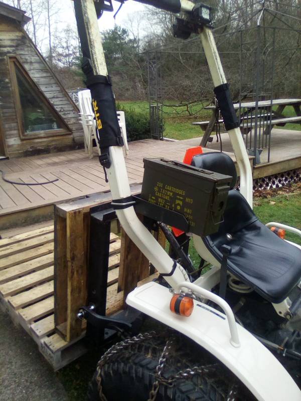

I've got a Bolens 1502/Iseki TX2140 that I'd like to put a toolbox on. I was thinking of using an old ammo can on the ROPS. I'm a bit worried I'll be hitting my elbow on it regularly.
What has anyone else done for this ?

I finally got around to doing something about a toolbox. It seems to be out of the way enough. Nothing fancy, an ammo box, angle iron and a u bolt. I did make some trays for the box, as I didn't want stuff rattling around in a big mess. I put a couple kerfs on the trays so they sit tight on the top, even when the tractor is idling.
The handle on top holds a pair of gloves pretty well too. I put rubber strips between the box and angle iron as well as between the u bolt and rops. Also put rubber feet under the handle, I hate adding rattles to vehicles. IMG_20201212_132619.jpegIMG_20201213_092306.jpeg
