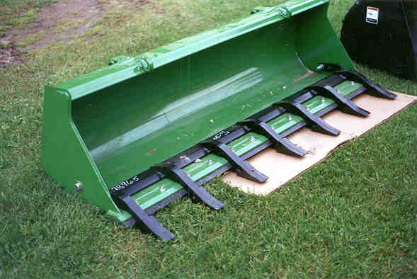

<font color="blue"> What is the best place on the bucket to do this?
</font>
See attached pic to view where I placed 3/8" grab hooks on my John Deere HD 73" bucket. They are placed directly in front of where the FEL arms hitch to the bucket. This will minimize the compromizing of bucket integrity when carrying or pulling heavy loads with the hooks as the FEL arms are carrying some of the load. Placing them on either end or in the middle of the bucket's upper lip may cause the bucket to bend under heavy load.
...Bob

   / Where to weld hook attachments on bucket #5
....better balanced while moving loads, too.

   / Where to weld hook attachments on bucket #9
One additional advantage of the 2 hooks placed in front of the FEL arms versus 3 placed at either end and in the middle is if one is trying to pull something with these hooks, like a stump, log, etc. One can drape a small 4-5' section of transport chain between the 2 grab hooks. Then place a tow chain's grab hook in the middle of the draped chain with the other end wrapped around whatever needs pulling or towing. This method minimizes load forces on both of the grab hooks and the bucket's edge by spreading them out over 2 hooks as opposed to concentrating the load forces on just the middle hook. The FEL arms will also be providing additional lift forces and bucket stability while maintaining the bucket's structural integrity without bending or popped welds.
...Bob
