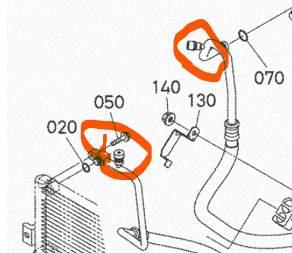

Does anybody know and can tell (or show) me where is the in port for A/C refrigerant on my RTV-1100C?
I've looked and looked and can't find it. Maybe been out in the sun too long...

Most will be at or near the compressor. Start there and work your way to the heater box. The smaller line will be the high side and the larger line will be low side (suction). Just like hydraulics.
   / Where's the refrigerant port RTV-X1100C? #3
They are under the hood, near the condenser.

AC refrigerant ports appear to be close to condenser. IMHO adding refrigerant to AC system without using gauges & monitoring pressures can cause AC system to emit warmer not cooler air depending on number of ounce's of refrigerant is installed.

Your comments and suggestions are appreciated - and thanks for screenshot, Tx Jim.
This thread was prompted by that 'I-need-to-do-something-right-now' mentality. There was no time to stop and play with gauges and monitor pressures. Ultimately, I did add a very conservative amount of refrigerant, (which is the ONLY good way to do this - if there is such a thing), and as a result, it cooled things down quite effectively and we got through a difficult planting time without anyone keeling over.
