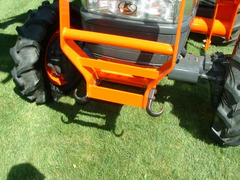

Which part(s) of your tractor do you like to use as tie down points when your tractor is on a trailer? I'm legally required to use 5/16 Grade 7 chain and binders where I live. A four point tie down is mandatory with one chain on the front and one on the back. I've been going through the loader frame and under the belly on my B2710 for my front end and it puts a bit of side pressure on the tires. Haven't had any problems yet. Would really like to avoid them if I can. Thoughts?

I bolted these hooks on to run my chain through. That keeps the front end front getting scratched. For the rear I put a clevis through the drawbar and run a chain through it. See attached picture.

Ideally you should use four separate chains & binders or straps & ratchets. If you're concerned about scratches (I had to give up worrying about that on my Deere quite a while ago /forums/images/graemlins/crazy.gif /forums/images/graemlins/frown.gif ), you can use chain guards which slip over your chain and prevent metal to paint contact when your chain is over painted areas. AWDirect is a great place to look for things like that as is M & R Products.
When I'm securing something for a longer trip I secure all four points. I like to secure to axles best for a couple reasons. They're not going anywhere/not likely to break and by attaching to them you can compress your tires a bit, too. I try to have about a thirty degree angle on my chains/straps from the load to the attachment point and try to have 4"-6" of "kick out" (that being the distance from a point of the chain/strap being perpendicular to the axle outward to the attachment point on the bed. Another little trick I use is letting some air out of the tires on the loaded vehicle then securing it as tightly as I can with the binders/ratchets THEN re-inflating the tires. THAT really tightens everything down. /forums/images/graemlins/cool.gif
