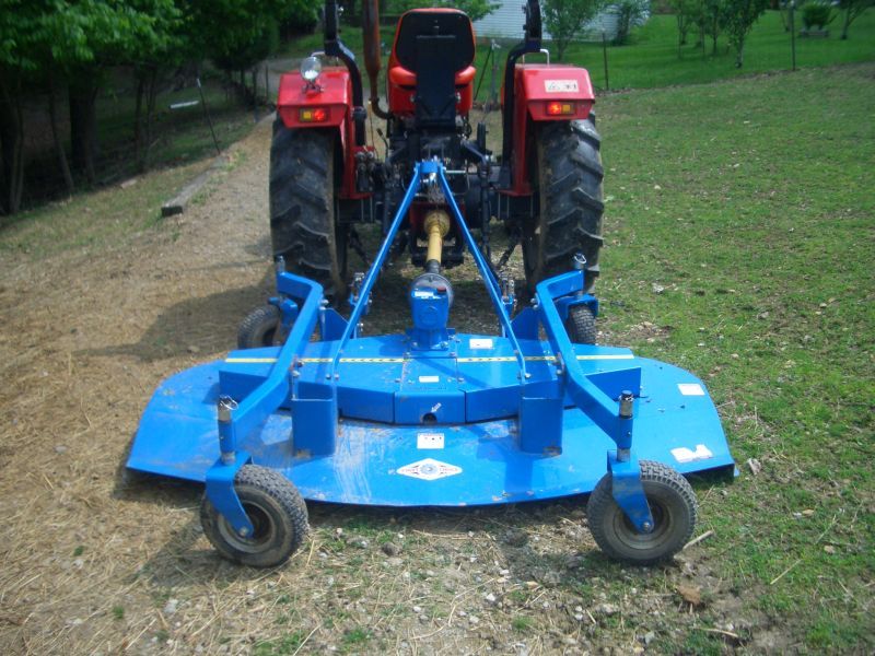

Based upon my own experience, I'm going to respectfully suggest that a 30hp HST New Holland isn't enough tractor for 20 acres, especially if there's any hillside work involved. I have 30 acres, about half of them in pasture. I thought a 25hp 4wd geared tractor would be about right for pasture maintenance. Not so, the hills (and gear spacing) were its downfall. I traded up to a 45hp 4wd geared tractor and never looked back. Later I added a 35hp 4wd geared tractor to the stable, but it too wasn't up to some of the taskings. In the end, it's the 45hp that turned out to be the real workhorse.
If your pasture grass thin AND you top it off faithfully - you might consider a heavy duty finish mower. I had an 84" First Choice (GM35-84) that did a super job. Bought it 2nd hand for $1000. The heat treated blades would slice through 1" saplings and woody stems like they weren't there. I set the gauge wheels up at the highest (6") height and set my ground speed as fast as my butt would tolerate the bumps. That said I think the 900 pound GM35-84 might be a bit heavy for a 30hp New Holland (unless you mow with the front loader mounted).
And to add evidence to what Leonz posted, I also have a 74" Ford 917H flail that would do what you ask too. But even though it's as heavy, the swath is obviously 10" less than the GM35-84. And equivalent flails have a much higher initial purchase price. When all else fails, I bring out the Kodiak MD60 rotary cutter. It's tough, has a slip clutch, hasn't met much it couldn't tear apart - but as others have pointed out, it can't do more than five feet at a time. And you may find you have to overlap swaths too, as deck suction on the first pass often isn't enough to pull back up what you just leveled with your tractor tires.
