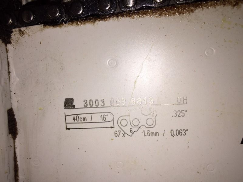

I'm going to be doing a good bit of cutting this weekend and figured it would be worth having one or two extra chains on hand. I was looking at chains online and was confused by differences in what seem to be the same chain. I have a Stihl MS261 with a 16" bar with the .325 pitch chain. Looking online they offer 16" .325 chains with 62 or 67 drive teeth, shouldn't it be one or the other? I was going to buy a standard (non chisel) chain. Please help school me in what I should be looking for.
Here is a picture of the bar on the chainsaw.

Didn't upload for some reason, let's try again.
Edit....the picture won't upload, I'll try again in a little while, never had this problem before.
   / Which Chain? #3
Unbolt the clutch cover and remove the bar from the powerhead. Look at the info stamped on the bar. A compatible chain will have the same PITCH, GAUGE, and DL (number of drive links) as indicated on the bar, regardless of chain manufacturer.

Used photo bucket this time and it worked.

That picture tells me .325 pitch, .063 gauge, and 67 DL, so any chain with those three characteristics (except NK chains) will be compatible.
