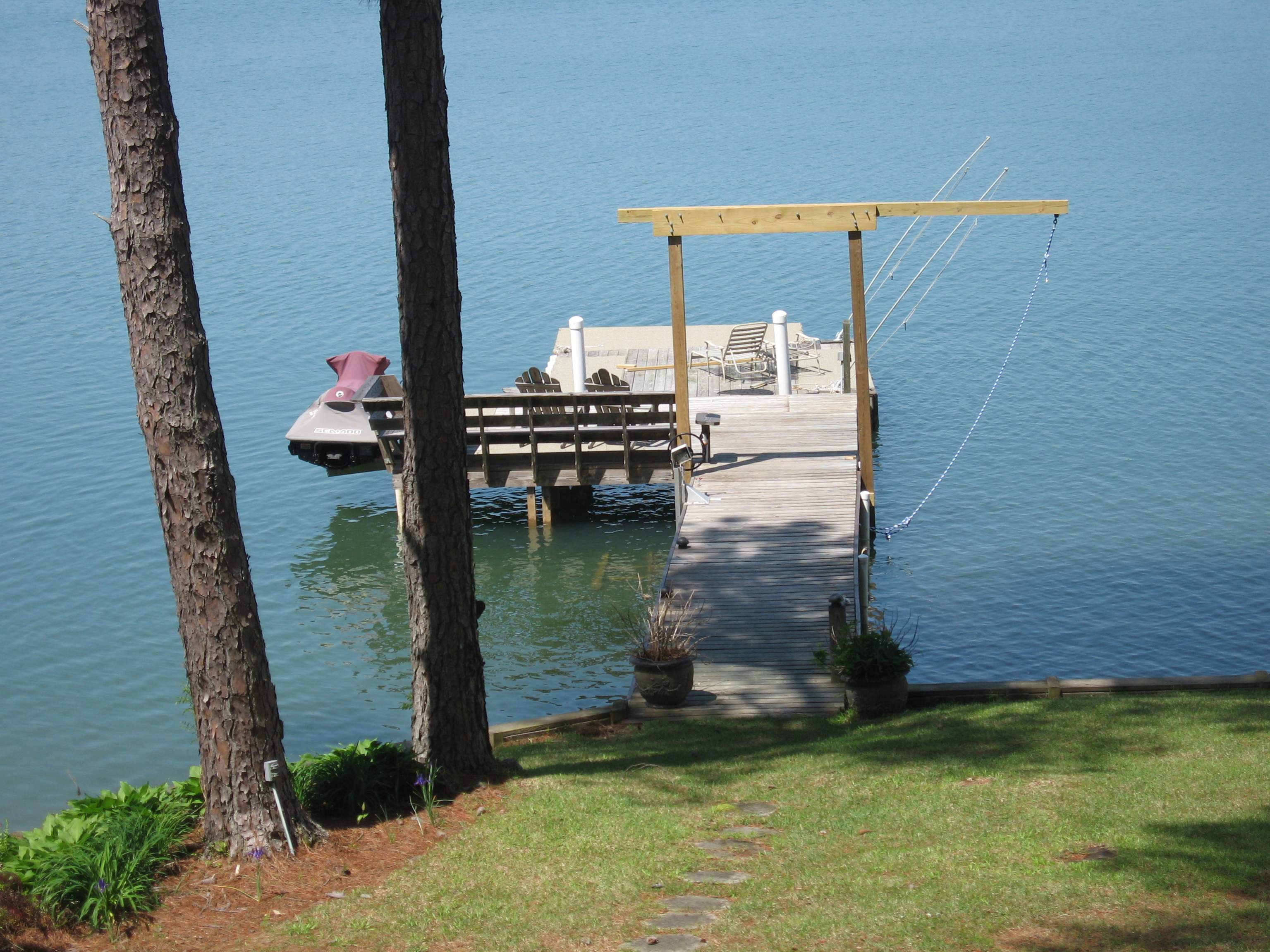

I am with you on this one. I have sealed my porch, deck, pier etc in the past but now would like to give it color with a good stain. Picture below shows some wood that needs some attention
