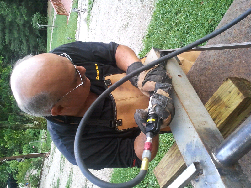

Another vote for needle scaler...
Put knotted wire wheels on your grinder
