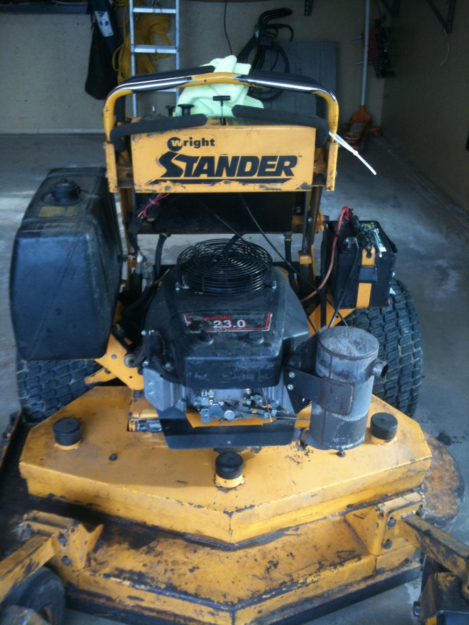

image.jpgI paided $2000 from a landscaper going out of business off Craigslist. I also got extra casters, filters, belts, washers for the casters (adjustments) and a ton of hand tools he had in a storage box. I have a 3/4 acre lot that I have to keep cut. It's pretty rough but the stander takes the beating (a lot better than me). I usually cut the neighbors lot and a buddy's too, about 2 1/2 acres total. Oh, he also gave me the grass gobbler. It just hangs off the side (gravity)by the discharge, very simple and easy to remove/empty.
