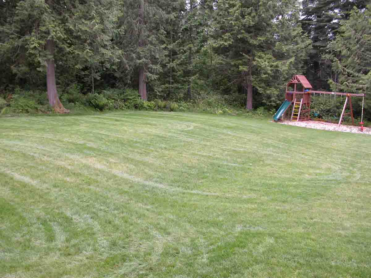

I routinely mow 3/4 of an acre, some of which is flat, some hilly with obstacles. I live here in the northwest which, contrary to what some believe, requires me to mow under wetter than ideal conditions. I have a JD LT160 with 42" freedom deck. I am completely satisfied with my JD and glad I didn't spend more money for the LT180. The extra hp is only necessary if you want to pull ground-engaging implements (like an aerator). My LT pulls a cart filled with firewood, boulders, kids, etc effortlessly.
I am not sure what problems you have been talking about with regard to the freedom deck. If the deck is clean and conditions are right (grass not excessively long and wet) than you will not see the clippings. If it has rained several inches over the past few days and the lawn has not been mowed in 11 days, than you will get some clumps, which can be removed by mowing over them. Note that the clippings are good for the lawn and bad for other parts of your garden if you discard them in piles. Why would you want to exert effort to do that?
Just my $0.02. See attached photo of the corner of my yard. More rain due in tonight!
Bonehead
