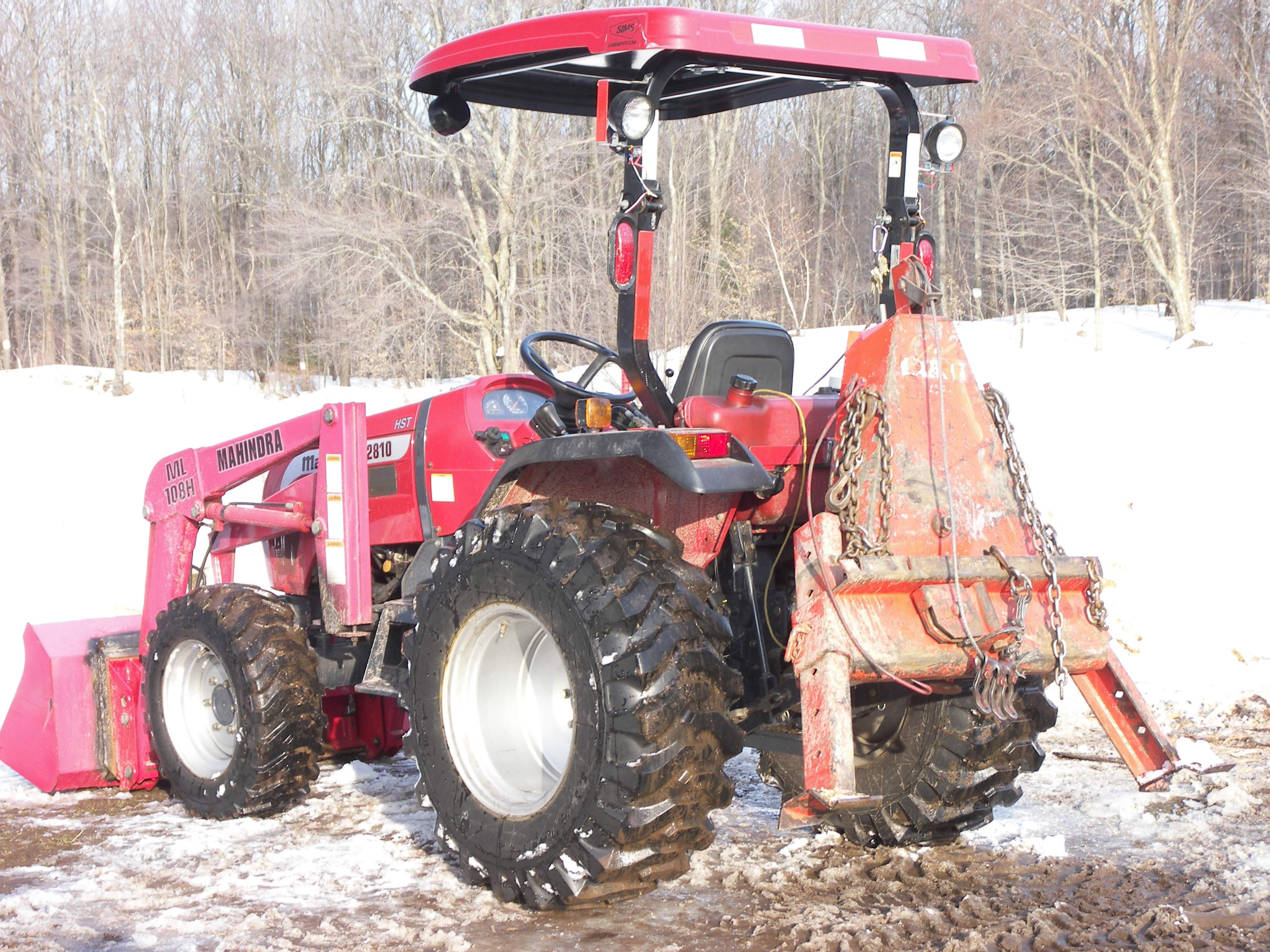

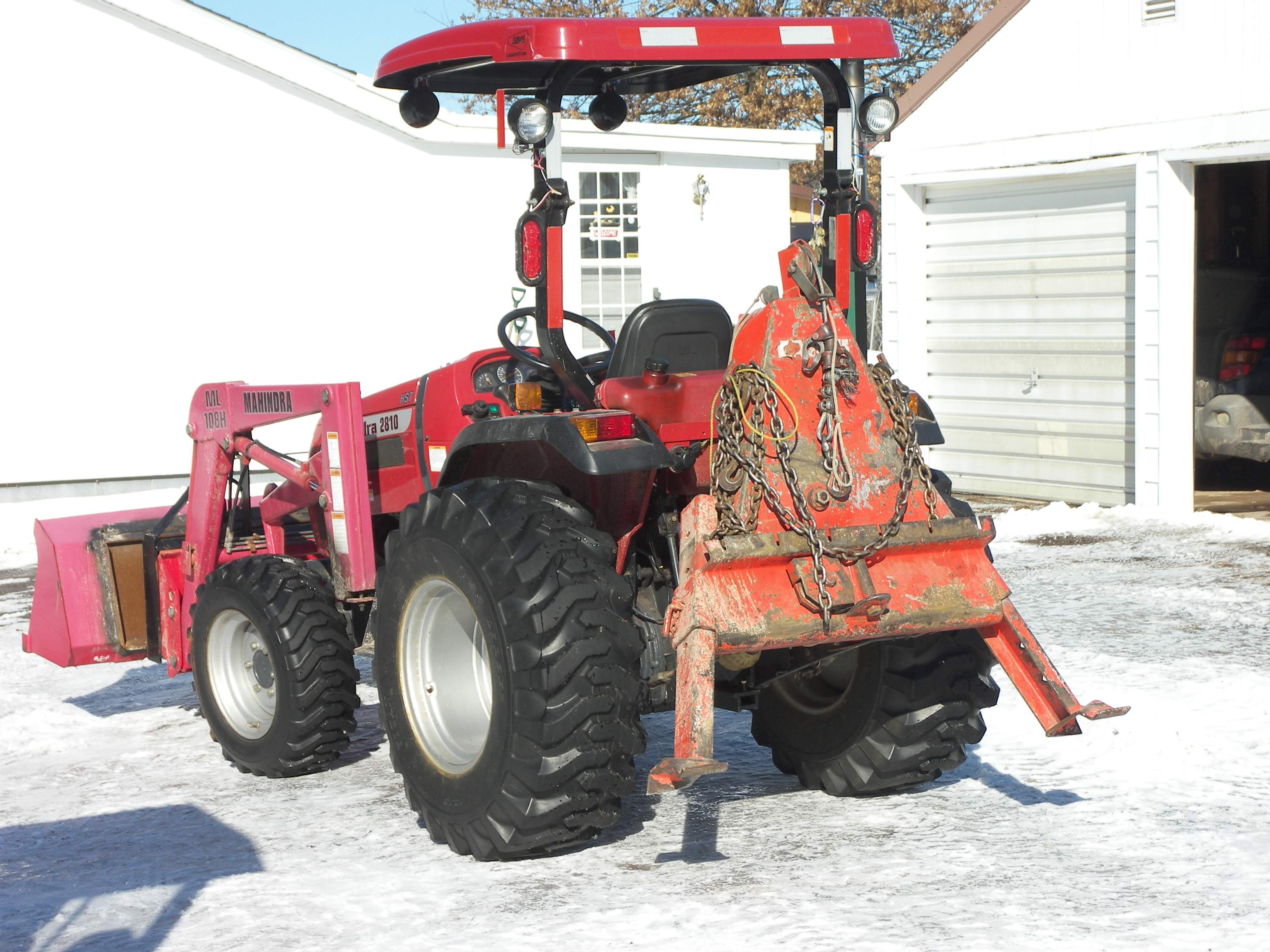

When I first started i was in the firewood business and bought a new farmi JL300 which now is an old one and rated at 40 HP. My Belarus 400 was 58 HP. I used it for 30 + years with no problems. I have a Mahindra and a kioti dk35seHST which its on now. I broke the rear axle housing and lift arms on the Mahindra last year. My welder made them better than new. I have had no problems other than the drive chain breaking on my winch. I would recommend the JL351, it is an affordable piece of equipment. The 501 is higher priced and high production machine.
When your pulling and you hit something the clutch slips on the winch. If your pulling and your log gets caught between trees its going to get ugly. Especially with a bigger HP tractor, my winch has snapped tree length logs in half. Wood really flies with these winches in more ways than one.
My winch has a ratchet paw brake, notches cut in the edge of the winches drum and a steel paw bites into upon operator aplication it works great but its manually operated by the operator. I am totally sold on my winch and if i were to buy another it would be a JL351p.
One thing you need to understand is putting a Farmi winch on your tractor (now i using Farmi because i own one) , you have now increased the capacity of your tractor probably 5 times. A lot of people laugh at these winches but. . . this is a serious piece of logging equipment.They are great for skidding with low ground disturbance. In your post you said you are not a forestry professional but with a winch you soon will be on your wood lot! These Machines are easy to use but. . . They are extremely dangerous too because of the cable. A cable pulling at high strength is subject to break no matter what its on and when it does some one or some thing is going to become a target! Don't let it be your body! Disclaimer: Severe injury or death will result in the misuse/abuse of this piece of equipment. Sorry i don't have any pics of mine pulling cause i'm a one man band. I'm sure which ever one you choose you will be happy with and it will make wood harvesting much easier, it sure has mine. . . If i can answer anything else PM me .. . John
