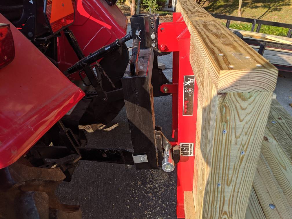

I know this is an old thread but hey I wasn't a Carryall guy then! Built mine on a Rural King Quick Hitch compatible frame. Basically followed a plan on Youtube by a guy name DIY My Way. TSC carryall frame is not QH compatible. I love my Quick Hitch and found the best place to get it is Harbor Freight with a 20% coupon. IMG_20190921_104401.jpgIMG_20190919_165848.jpgIMG_20190918_184313.jpg

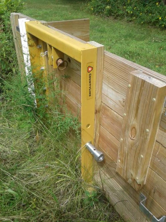

DIY My Way also has a follow-up video of mods others made to his plans. A 2x4 spacer between frame and back wall will allow QH hooks to engage frame.
