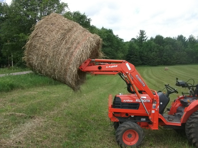

the 4 by 6 bales we are feeding weigh 1200lbs.the 5 by 6 bales can weigh up to 2200lbs depending on the crop your balong an how the baler is set.weve moved an fed 5 by 6 bales with a 55hp tractor no prob.an we always take 1 on the rear an 1 on the loader.most 5 by 6 bales are 1500 to 1700lbs.
