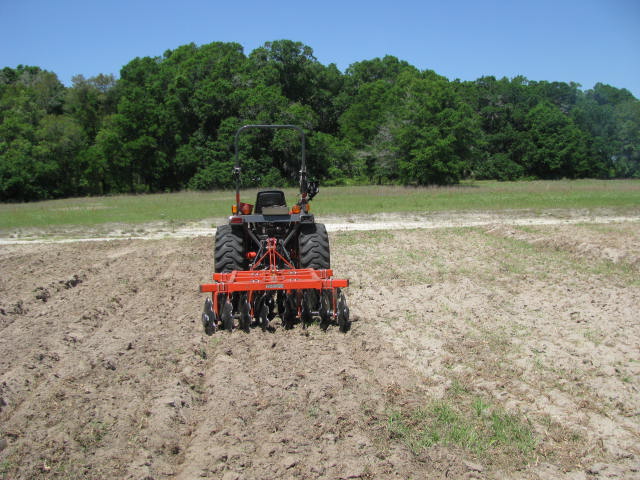

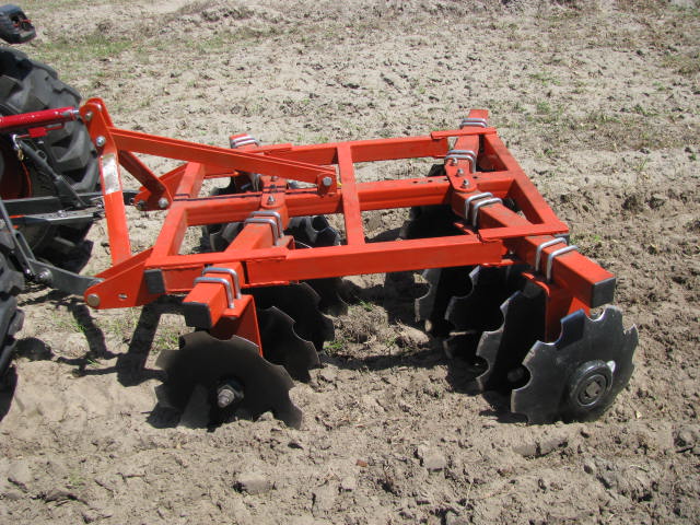

Based on my satisfactory experience on a smaller Kubota B3300SU I think the L3800 would be ample. Maneuverability is important for the tasks you have listed and you loose maneuverability quickly as tractor size increases.
BE SURE TO BUY AN FEL ON THE TRACTOR.
I would consider a simple, versatile 16/18" or 16/20" disc harrow before buying a PTO powered tiller.
If two implements will do the same job, one requiring a PTO hookup and a second not, the second is definitely preferred.
LINK:
http://www.tractorbynet.com/forums/attachments/275147-disc-harrow-primer-howse-disc.html
