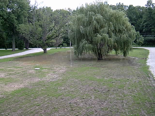

The CFO has already said I can buy a new tractor when she's working again. Now that those prospects are looking pretty good, I'm drooling over a couple of possibilities...
First, a little background-- We have roughly 3.6 acres, 210 feet wide by 760 feet deep. The house is about 250 feet from the road. The lot is very flat, except for a low spot that runs from roughly 50 to 100 feet from the road. I'm attaching a recent picture of it. (Bear in mind that we've had over 12 inches of rain this month, usually by July it's hard ground and you can drive right through it!) Anyhoo, the lot is generally flat but wet (mushy). I drive over some of the property with the 8N and create ruts while I'm mowing. The lot is treed but not wooded (I would call it "park like").
Here are my possibilities for roughly the same amount of money--
I was looking at 25hp models from Homiers and Northern Tool with the FEL. Since I think this would be too much weight to mow with in my newly seeded yard and septic field, I am also considering a 48" riding mower to go with it. I would use it to cut the grass in front of the house and probably about 50 feet behind the house, and use the Homier or Northern Tool model with a rough cut mower to do the back that no one really sees.
I am also looking at New Holland TC18 with FEL. With the lighter weight, I would also use this to do ALL my mowing. I would either get a RFM or a MMM but I keep going back and forth on that also. I know there's a great debate on that one too, but what would be best for what I have? Also, if I bought the NH, I would get it with the R4 tires.
Given the backgroung information above, what would you all suggest? Any other recomendations instead of what I'm looking at?

I've got 11+ acres (3ac dense woods 3ac in crops) and use a Cub Cadet lawn tractor with 54" deck plus a NH TC24D with a rear discharge Befco 60" finish mower. The little Cub can mow the whole property. I think your NH TC18 would make you very happy, it is small, light and will turn on a dime. My TC24 turns almost as tight as the Cub Cadet, but the ROPS hits the smaller trees.
I like the frame size of the NH, it is big enough, but not too big. The Northern tractors are another frame size larger and don't have the tight turning radius of the TC18/21/24.
Also, just for comparison, I also have an Oliver Super 55 Diesel with is almost identical in size/weight to your 8n. After getting the NH TC24 we completely stopped using the Oliver. 7' diameter turns versus 25' turns. I gave up some power but not enough worry about, even when I put a blade in the back and pull the ditches. The work gets done faster with the smaller tractor.

Not to start a war or anything, but your needs do not match up well with a Northern (chinese) or grey market tractor. You need something with a live, mid-pto and a good MMM. The aforementioned BX would be my first stop, the TC18 is another great option with a bit larger frame. I know many folks who use a BX as a primary mower, alleviating the need for a second ride-on of some sort. You didnt mentione budget, though - and since you looked at Northern I fear you may be trying to do this on the cheap - which is fine.
If you cant swing a new BX (great financing right now) look for a used smaller (possibly hydrostatic) machine which will get you the live pto and likely MMM. Good examples in the $5,000 range would be '80s vintage Kubotas (B6100, 6200, 7100, 7200) or Fords (1210, 1220, 1320, etc). You may also run accross a Case/IH 234 or 235 both of which were made by Mitsubishi and often have a MMM. All of these options are essentially forerunners to the BX. Same idea, but cheaper due to age. Many are in great shape since they have been stored inside and used primarily for mowing.
Just my two cents, but in terms of reliability, resale, parts availability - I would take a 20 year old Kubota or Ford over a lesser known brand.
