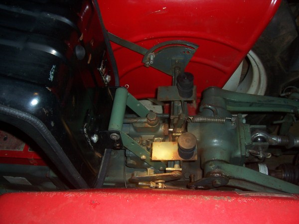

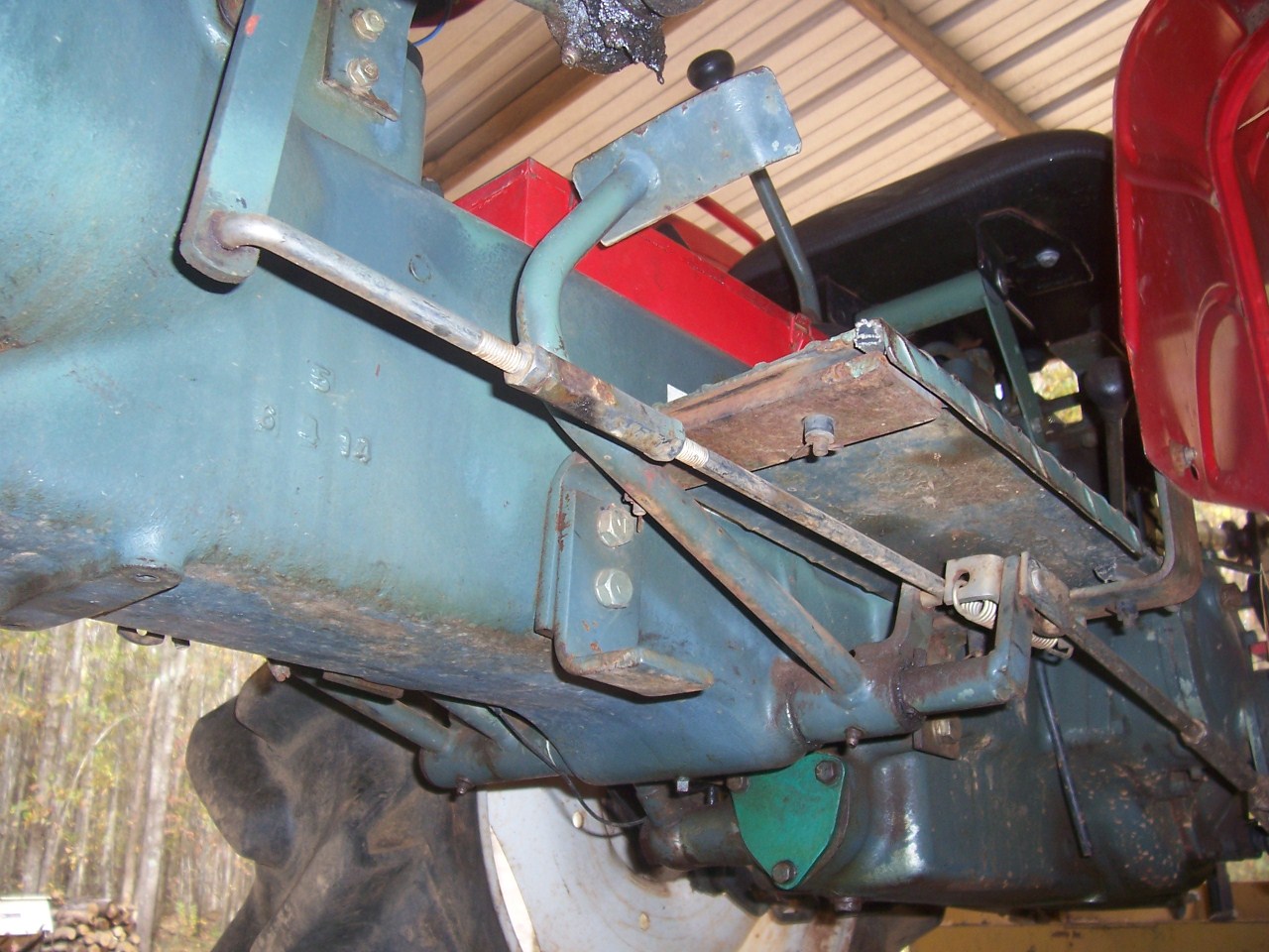

Height adj..jpgHyd. Filter.jpgHere's a pic. of my YM2000 setup. Don't know the 3110 but maybe the same. At the bottom of the Pic. inside LH. Fender. The Shaft to the Lift Arms are Adjusted by the Locking Nuts. Which the linkage/Shaft is connected to the Control Valve. When the Lift Arms reachs the Desired Height that is were you Adj. the linkage to Stop. Or releave the Pressure to the Valve. "Pull the Tab away". If I recall which is still Difficult. The way I adj. my linkage/Height was raise the Arms until it began to Whine. Or reach the Highest Point and then Shorten the Linkage" Adjusting Nuts" to Relieve and Stop the Lifting and Tension to the Control Valve. In the 2nd. Pic. is were My Pickup Screen is located. I bought it AS IS and was getting the same problems you discribed. When I was Serviceing it I had to Replace it. It looked to be a VN. Ghetto Rig. Bent up, Beat up and looked like someone tried to Solder and Replace the Screen. It worked but I gladly payed the 55.00$+ to replace it. Almost 5 Gal. JD.303. and I haven't had a Prob. since. ;)

The set up for the 3110 is the same as the 2000 like in carey's pic under the seat .His screen will be at the rear (under PTO) I've only changed my hydro oil once since I've had the tractor. If you don't know what type fluid was used, you may want to change it so, you'll know what's in there. Next time I change , I think I'm going to transmission. This hyd fluid gets hot in the summer during extended use,and the loader slows down, won't lift as much, etc,. I don't know how to keep it cool . Tranny fluid may do the same, but I won't know unless I try it. I may end up having to install some type of cooler somewhere
