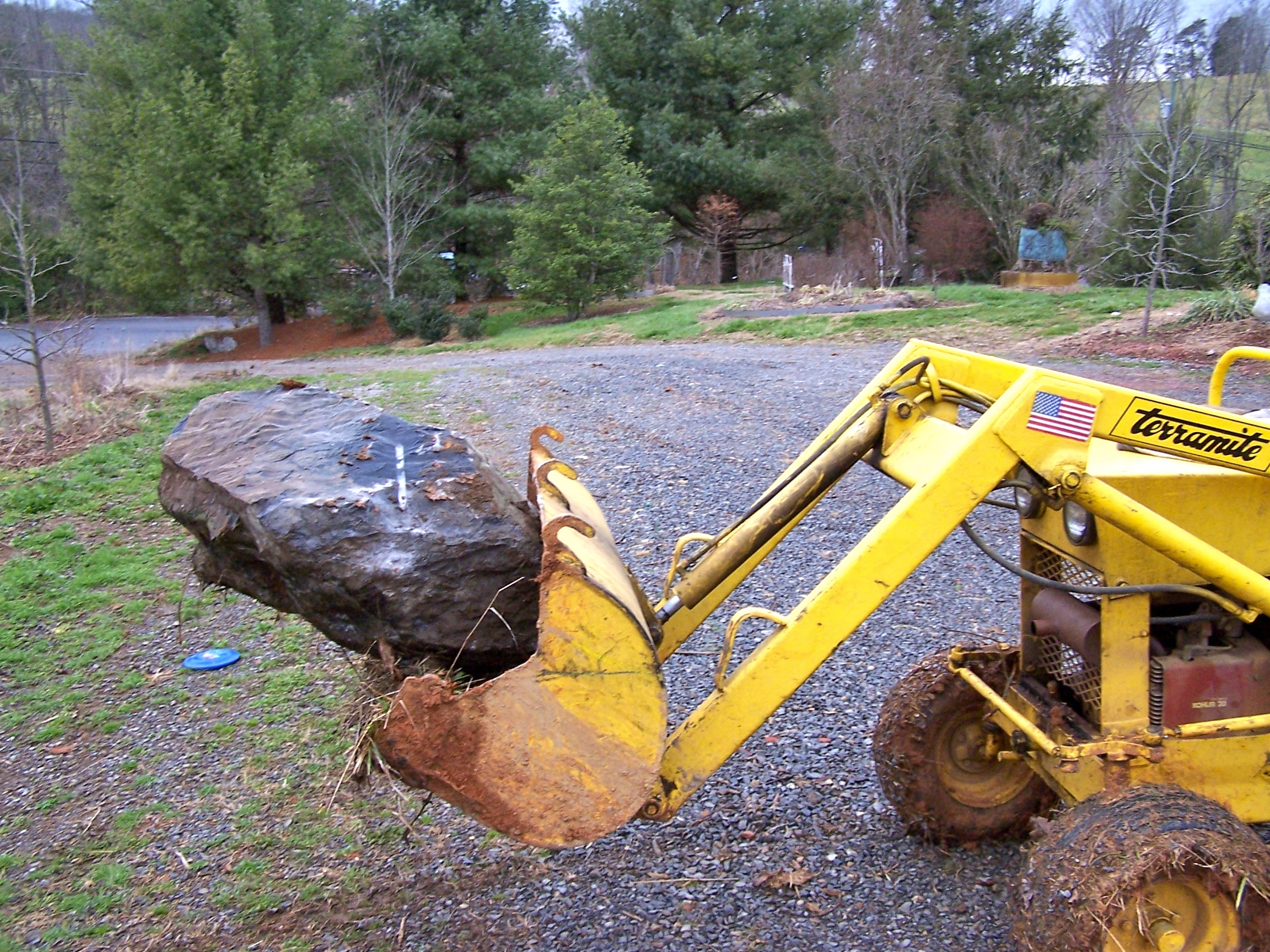

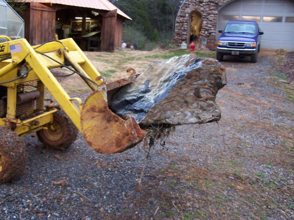

I think the whine is normal on these machines, I wear ear plugs because it's annoying. I had a T5B for many years and never felt the curl was lacking. See the photos. My T6 also has only one curl cylinder and I'm quite happy with it as well. Could be your cylinder needs a ring kit.
