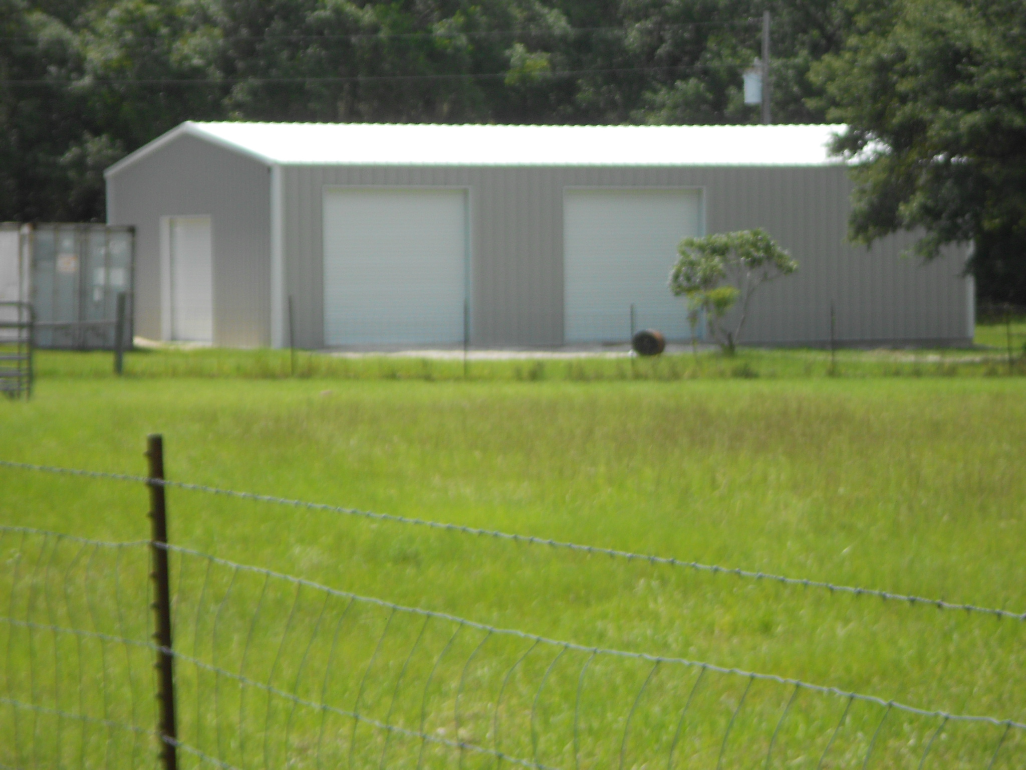

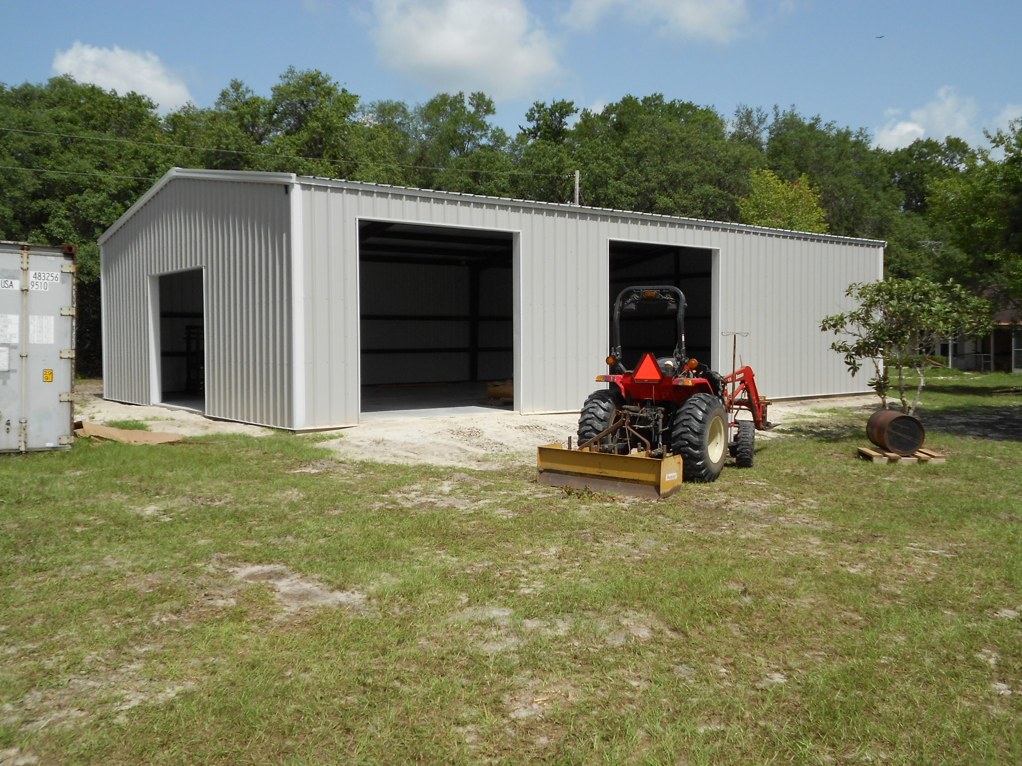

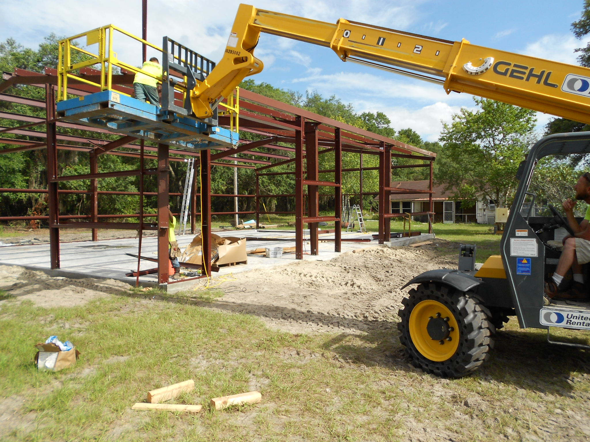

I put up this 40' X 60' X 14' in June 2015. I ordered the building from Hercules Buildings in Jacksonville Fl.
There are a couple building manufactures in Adel Ga. who sell only to retail dealers around the country who put their name on them.
The install crew out of Adel came to my property after assembling a building in Louisiana!
The 3 man crew with a Lull forklift took 7 days BUT had rain about 5 days to deal with.
They did a perfect job! (I know of a building that was put up and it wasn't square, they cut the edges of the roof panels to fit!!)
