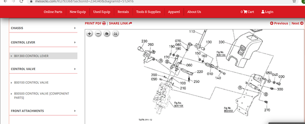

I have a MX6000 several hours away with a loader joystick that will not move. No access to internet or phone onsite. Is there a lever that locks the joystick that prevents it from moving? If someone could post a picture that would be awesome.
   / Who has access to Kubota MX5400/6000 Cab model? #2
It looks like part 230 is a lock lever and sticks out of the plastic trim right in front of and under the joystick.

Sure seems like I would have noticed that lever but I did not. Plus that looks like it would need to be lifted to move to second position. Thought there be something I bumped to cause joystick to lock.

and there's no lock-out lever like is shown on that schematic???
Well I’m 3 hrs away so I can’t check. However don’t remember seeing a lever like that.

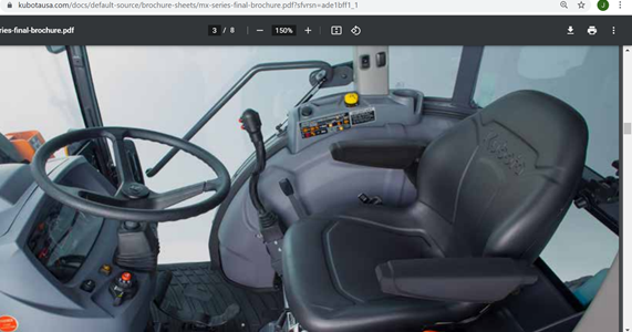

Does this look like your cab and joystick layout? This is from an online Kubota brochure. You can see a small lever sticking out at the base of the joystick on this one. Doesn't seem quite as obvious as what I was expecting to see based on the parts schematic.
Will be interesting to see what you find when you're able to check it out. Hopefully you just bumped this. Hard to see what else could completely lock up your joystick.
