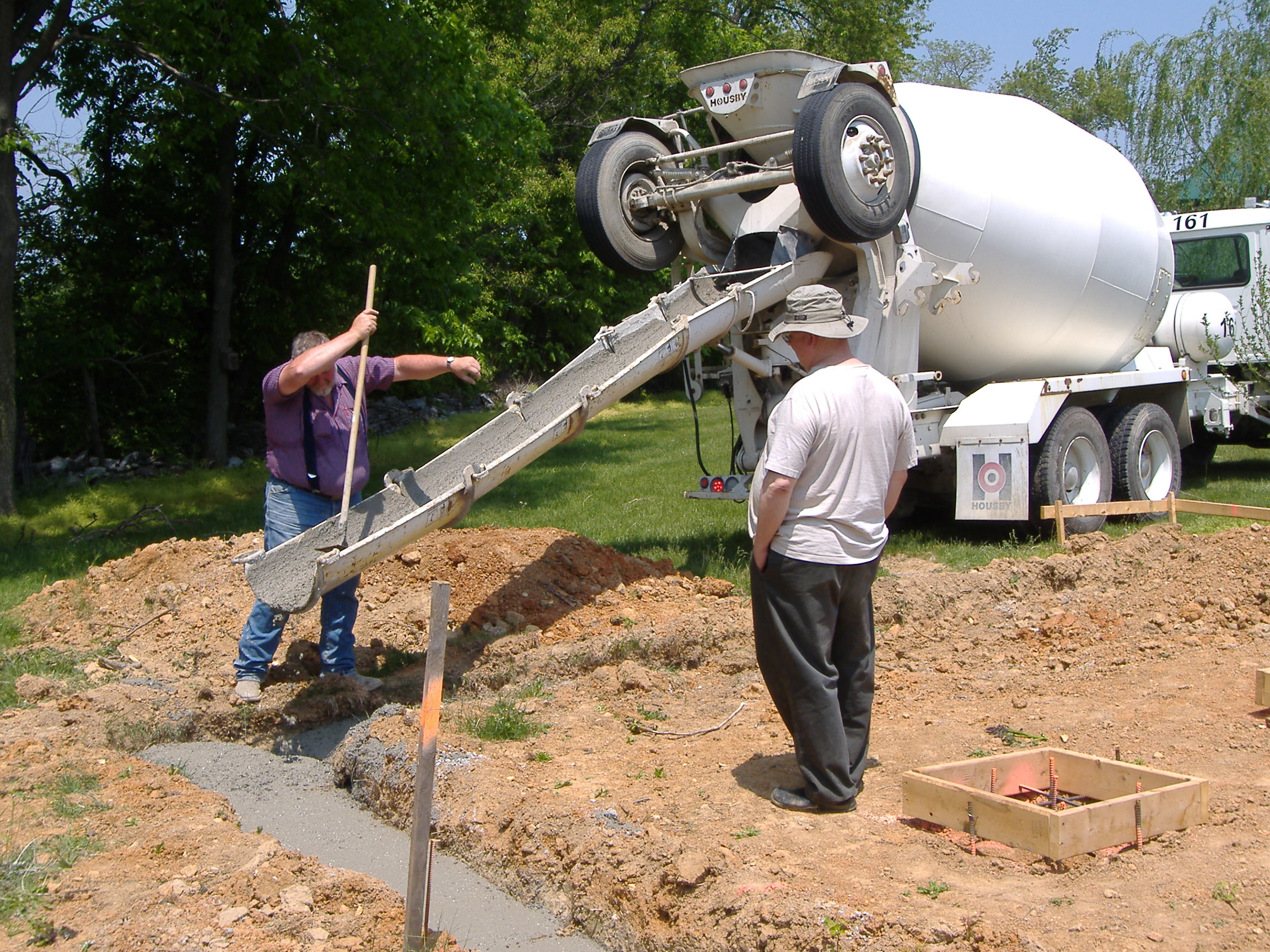

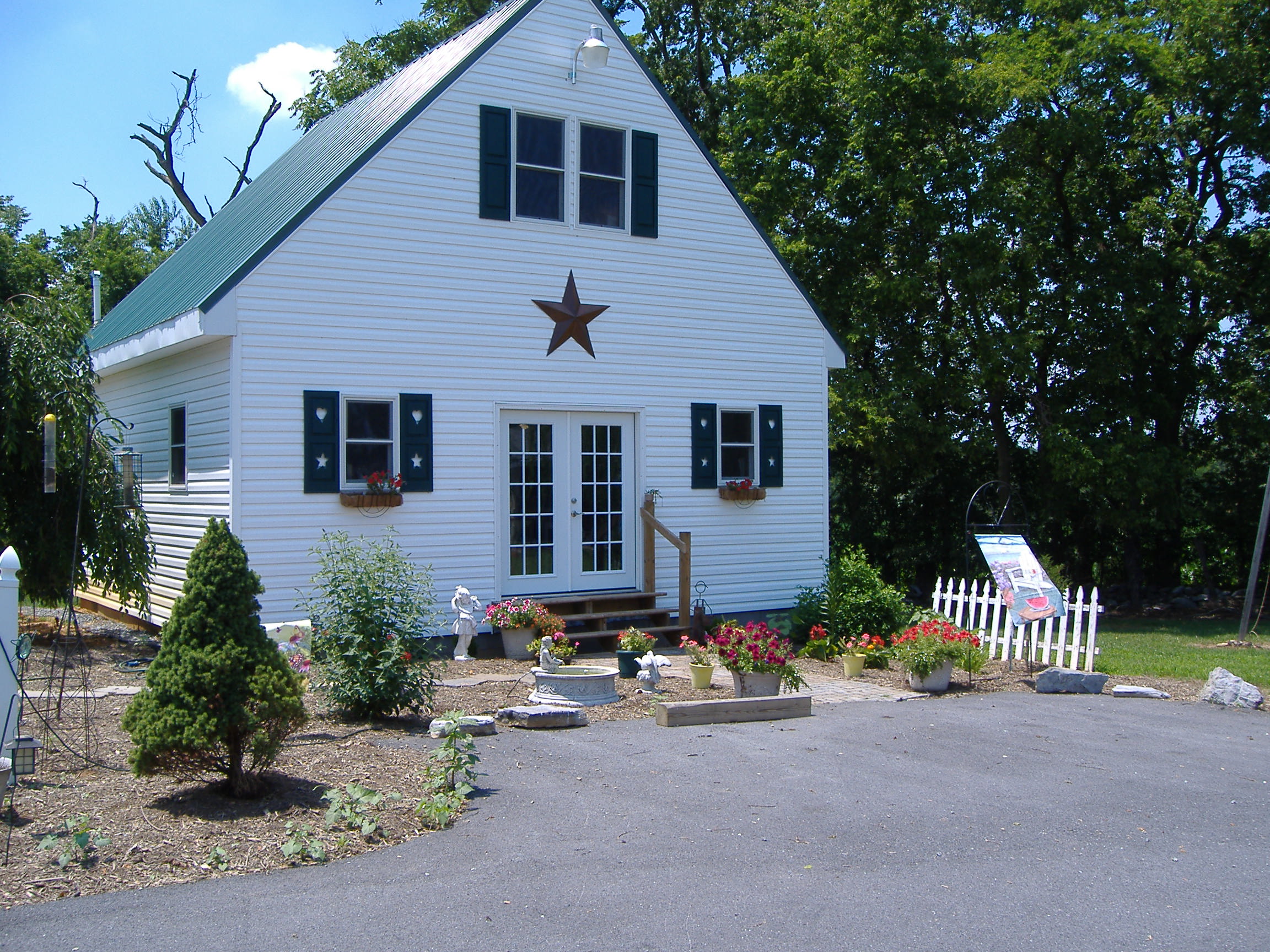

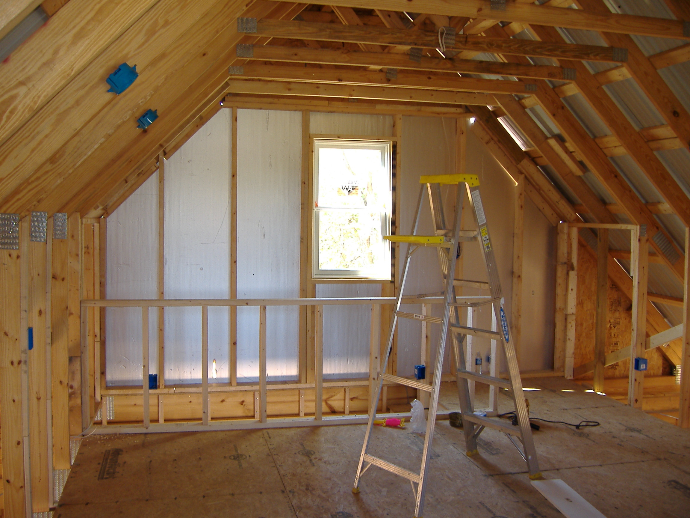

I think a 16 x 26 addition can be pretty much a DIY project for you.
A couple of years ago, I built a 24 X 24 building for a studio for my wife - 90% myself. I just needed help for the following:
1) Concrete company to pour the footers ( I dug the trench 32" deep and laid the re-bar myself). The foundation is concrete block to 18" above grade for a crawl space)
2) My son-in-law to help me stand up the walls (I built and sheathed them laying on the floor deck)
3) My son-in-law to help me fly the roof trusses in and secure them place (we used a towable "bucket lift" to get them up there then I secured the trusses to the walls while he secured the truss-to-truss bracing)
4) I was running out of time so I hired out the siding or I would have done that myself too.
I started in late April and finished in mid-November (of the same year)
I keep having the same thoughts as you about putting an addition onto one end of my house... maybe one of these days.......
Best of luck to you.
