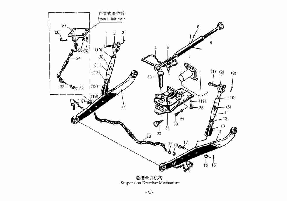

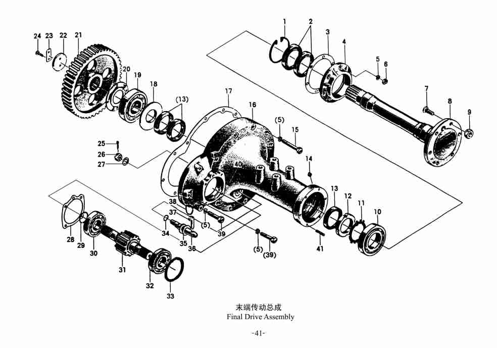

Hello All,
I was out disking my place this afternoon and all of the sudden the disk was dangling by only the top link and one sway bar on the lower 3 PH.
I stopped the tractor and found one of the lower bar pins, closest to the rear end, had somehow worked loose and disappeared. I looked high and low, but think somehow, it got burried by the disk. I looked at the other side and noticed that the pin is locked into place with a set type screw/bolt.
How do I order another for a Jinma 304? Any idea's who would carry one of these?
I need one ASAP to continue my disking
Thanks in advance for any help anyone can offer
Rick
   / Whoops! #2
Not sure from your description what actually went missing. Perhaps you can identify the part from the attached diagram. Or did you lose the pivot pin/fastener that actually holds the liftarm (#21) swivel ball to the axle housing ? I think that's #34-38 in the second diagram

   / Whoops!
Hello Greg,
Yes I lost 34-38, on my parts manual for the tractor, it looks a little different, but I lost the screw that holds it in and then I guess the fastener just worked it way out.
