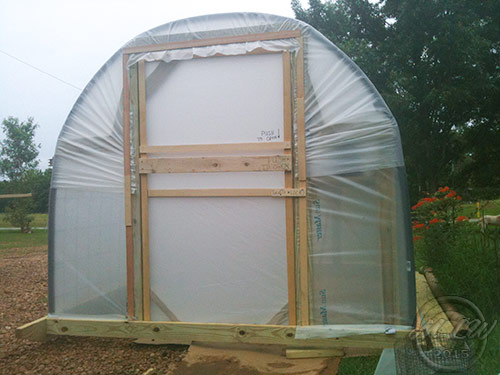

I built one like the one shown here at this link... Greenhouse | Homestead Advisor
Very simple and cheap. My greenhouse is shown in the attached image below
