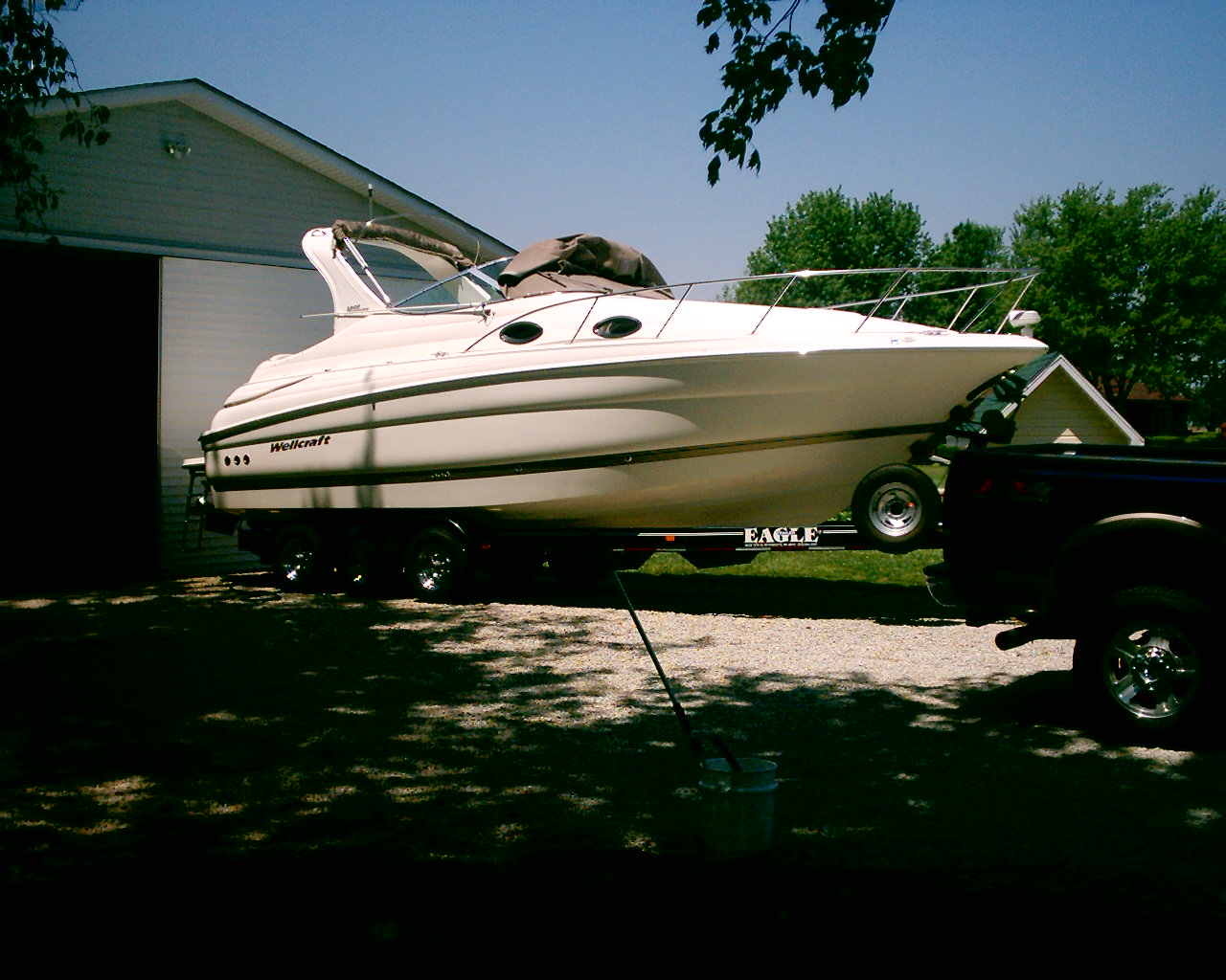

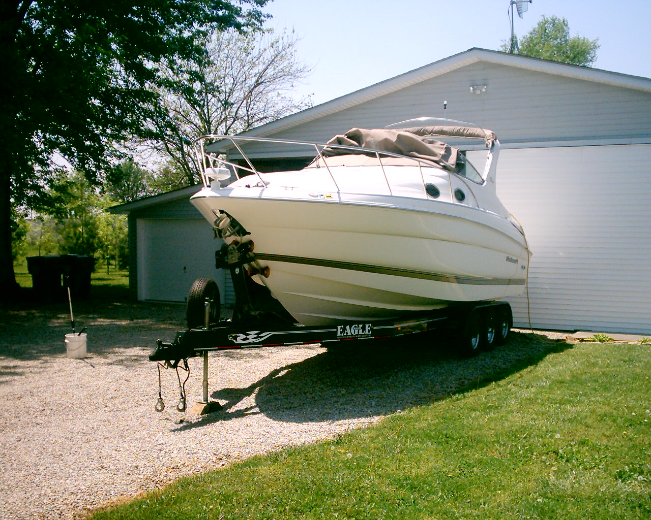

I would check your friends owners manuals under towing and I am sure they are going to have a stipulation on WD hitches. It is just not printed on the hitch like your Fords is. Now that being said I bumper pull my boat, 15,600# with my F-350. I upgraded to a 15,000# 2.5" receiver with a matching ball and mount and have no problems. I have used this setup for over 10,000 miles in the last 3 years.
Chris
