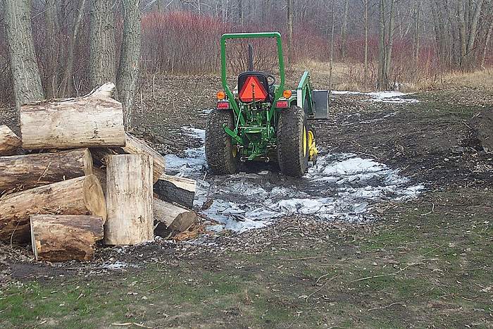

There's been a lot of postings with the question: Do I need four wheel drive.
Here's a shot of my tractor stuck in two wheel drive. Notice the conditions are really not that demanding. I got out by simply engaging the FWD.

Yeah, I have the MMM on. I wish I would have gotten the rear finishing mower. In this case, however, the tractor broke through the ice and the wheels were simply spinning in mud.

<font color=blue>...Here's a shot of my tractor stuck in two wheel drive. Notice the conditions are really not that demanding. I got out by simply engaging the FWD.</font color=blue>
Funny, you don't really look stuck. Even the diff lock didn't help?

I didn't try the diff lock. I should have tried it though. I have generally used diff lock when spinning tires while loading dirt -in FWD-.
