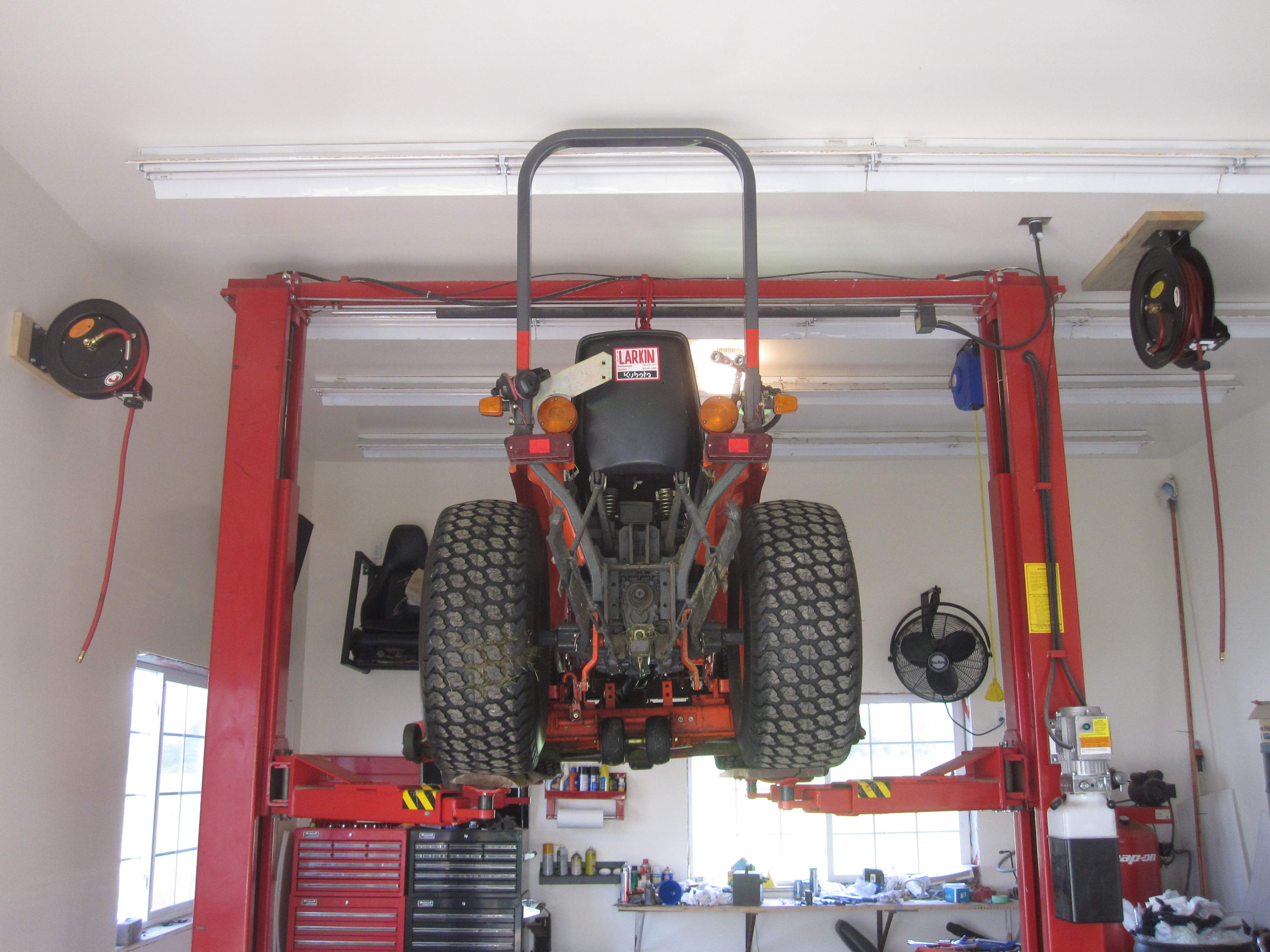

This one's for the archives because when I went looking, no one had written anything on the subject.
Why it is a bad idea to raise a Kubota tractor on a car hoist | Walnut Diary
   / Why it's a bad idea to put your tractor on a car hoist #2
The way the writer did it (park brake on and tires sitting on planks sitting on 6 inch square lift pads) would be dangerous. But, some of the lift manufacturers make tire pan attachments for their lift arms that cup the tires. And some make drive on ramp attachments too. With most of our tractors weighing much less that a full sized truck I don't see a problem with it as long as you have the correct attachment to keep it in place on the lift arms.

I don't see the problem in the photo. (And the link is blocked.)
   / Why it's a bad idea to put your tractor on a car hoist #4
Doesn't take a rocket scientist to know not to lift that in the air by the tires like that. Especially anyone that owns a lift ought to know better

This could be done safely but not the way he did it.
   / Why it's a bad idea to put your tractor on a car hoist #9
2 post lifts are designed to lift from the center of gravity of the car. The center needs to be as close as possible to the lift's posts. The further it's off the more force you put on the lag bolts. If you have loaded rear tires you will be putting too much weight on one side of the lift unless you account for the extra weight. It may not fail the first time but that doesn't mean you're safe to do it repeatedly. Every manual for 2 post lifts I have seen always have a section on how to determine where the center of gravity is for generic vehicles with warnings that death can result if you get it wrong.
   / Why it's a bad idea to put your tractor on a car hoist #10
And the guy would stand under it just to get the blades off? Way too high, off balance, and relying on brakes to keep it on the tire pads?
