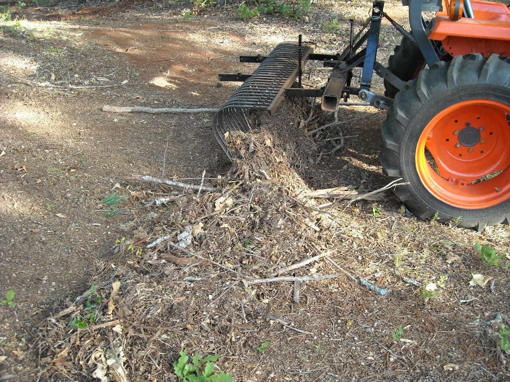

Well I still don't see the big need, or at least everything I have done with mine has not been a problem. I posted some pics this morning in the attachments section.
for 1 my rake doesn't dig into ground. I was playing in some sugar sand this weekend and no problems.
If the ground is hard, it won't attempt to even dig into the ground.
Although it will move around a little material, it's not a boxblade.
Even with gauge wheels, if it hits a somewhat solid bump, it'll drag right over it, it doesn't have a sharp cutting edge like my BB to cut it off. A 3pt that locks the upward motion would help a little. But most of the small tractors don't have much float control.
JMO..
