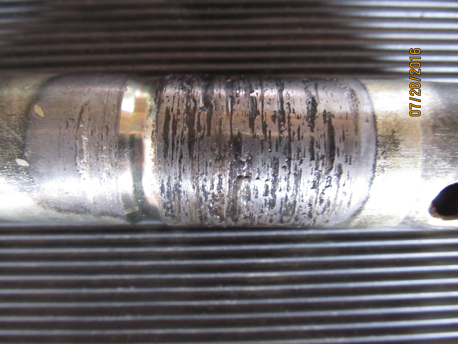

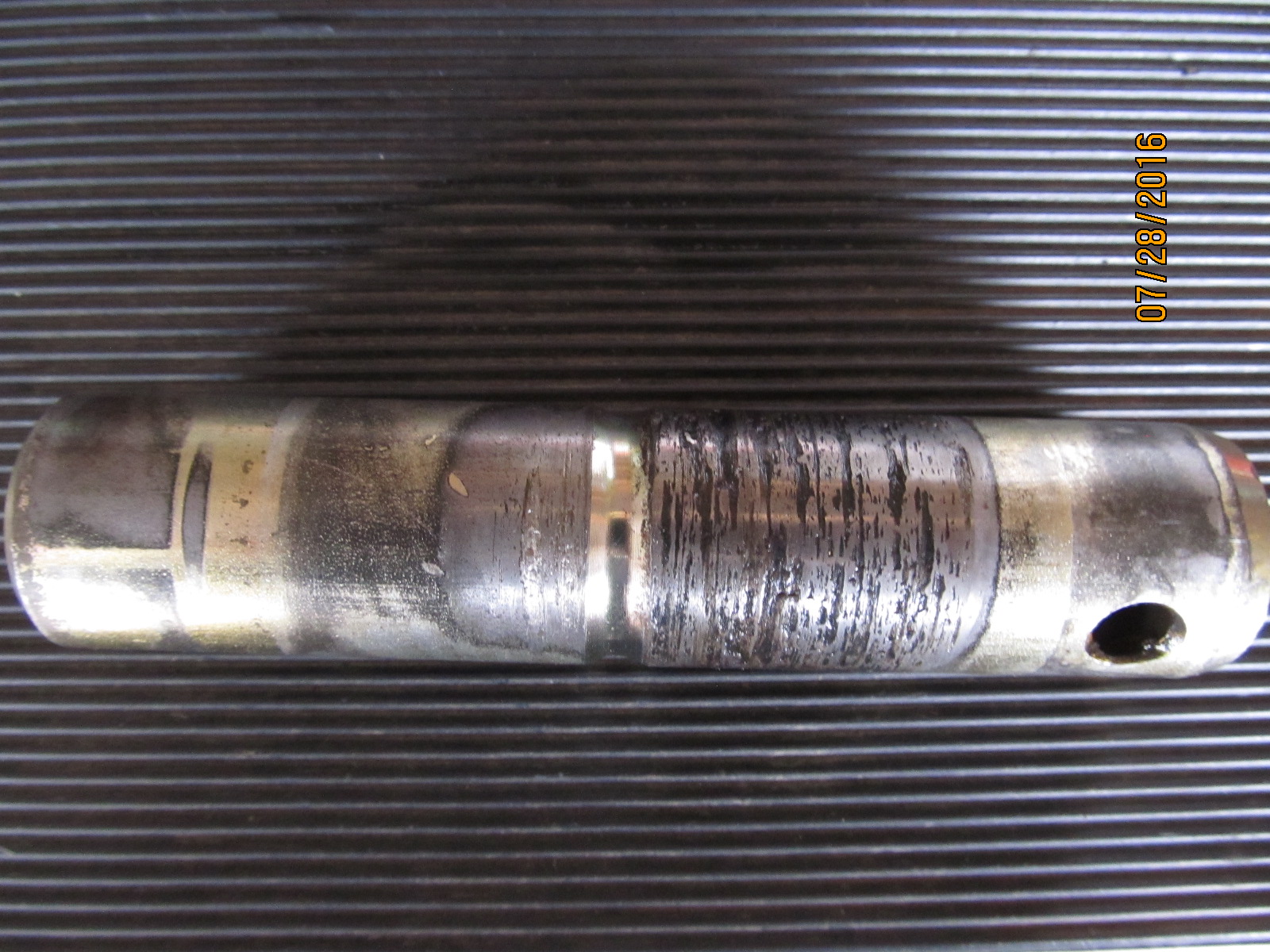

This is from a new to me M6800 Kubota loader pin from the boom cylinder that makes the loader go up and down. What caused this? Dirt? Grit? No grease?
When you buy something it's always a good idea to take it apart, change everything and start over. In doing that, all the pins were perfect and looked almost new except this one. The cylinder rod end has a little scoring but not very much at all. Just this pin. Is this typical looking? Maybe the pin metal was soft?
Anyway, here are the pics. What do you think?

Lack of grease. I bet the zerk (Clogged) failed and never allowed grease into the pivot.
An astute owner would pick up on it, but not all owners are astute.

WOW! big time no grease, they had to hear that making noise! I'd hate to see what the bushings look like!

Galling, I'd call it, and lack of lube is the cause. I'd have a careful look at the bores also. The idea of a clogged zerk makes good sense.

On most ag/construction equip, the pin is made to be the wear item and not the bushing. Pins are easier to make/change.
And agreed, no grease. Sometimes zerks plug up. When I have that happen, I change them. Others tend to ignore them and just grease everything else instead. Looks like thats what happened here.

When you start hearing that eeek..squeak sound, it would be a good time to stop and figure out where it is coming from and why that zerk is not taking grease. Otherwise you wind up with something like that.

The bushings/pin ends look good with only light scoring on the cylinder end.
I wondered about that since almost no scoring except on the pin.
