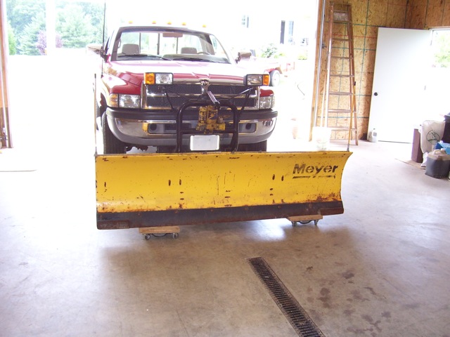

When I plowed commercially with my pickup the owner of the company wanted no shoes used. He too wanted the blade directly on the roadway. To increase the wear of the blade I welded thick pieces of metal on each end of the blade to increase the life of the blade. Hopefully in the picture you can see the pieces of metal that I added.
