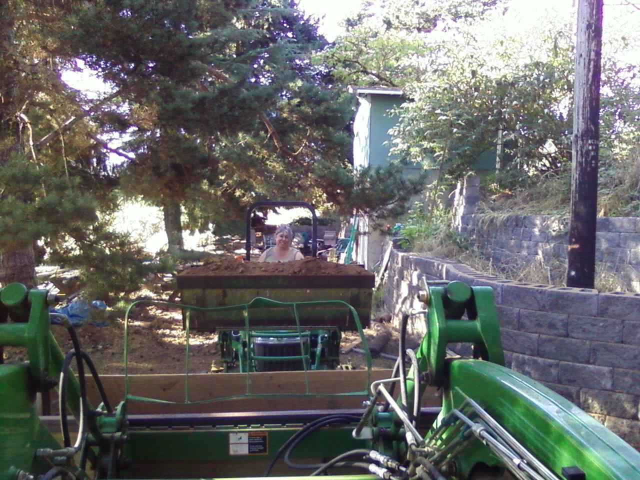

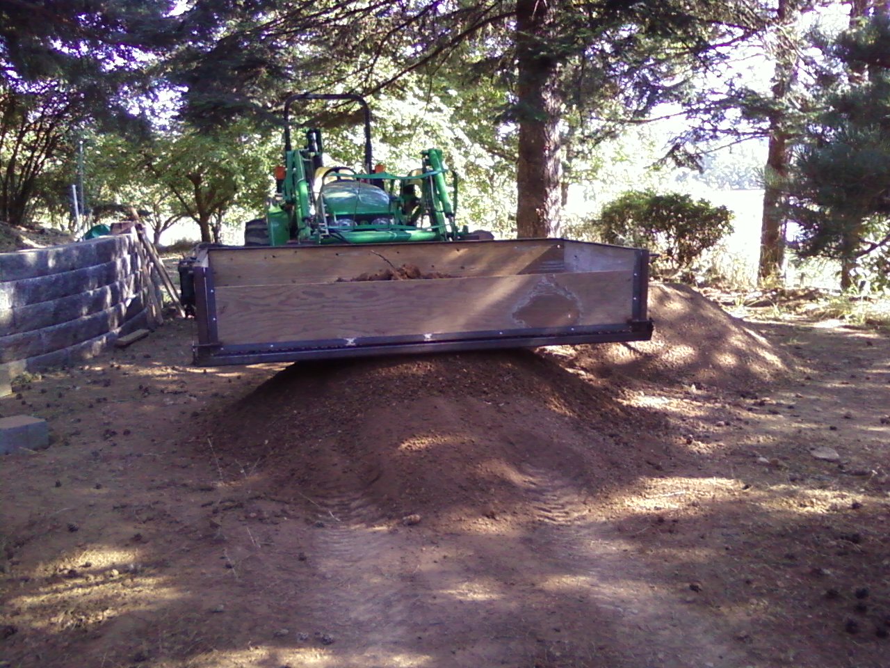

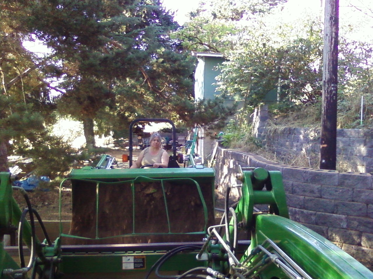

My solution to a dirt sifter. Lots of "dirt" but it has too much crud for the planting beds. I tried a sloped passive sifter, but it didn't work well. The sifter is mounted on the forks and allows me to process the dirt as fast as the wife can load with the 2305. I use the front remote to control the dumpgate.
Couldn't use this method without two tractors. This also keeps the wife involved.

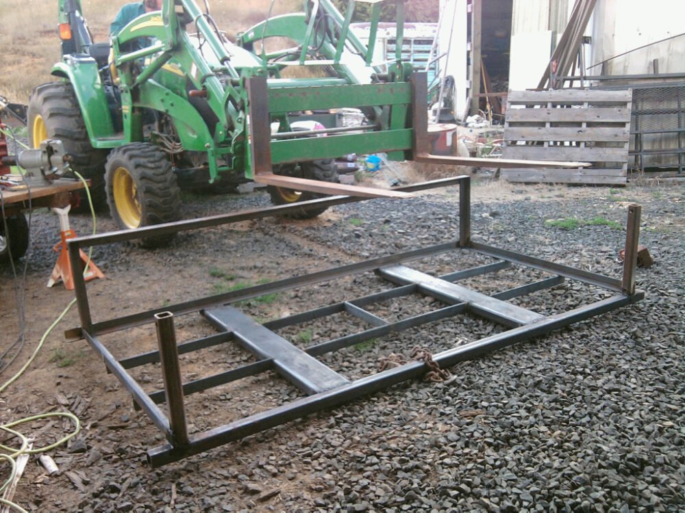

Can I ask what you use as the sifter and how you attached it to the box? Tried building one of these but have struggled to get it to stay together due to the weight.
   / why two tractors? My reason
The sifter mesh is 3/4 expanded metal. It is held in place on three sides by the wood, and on the forth side by bolts with washers taped into the front crosstube. Pix shows the frame better. The 1/4" x 2" bars provide the rigidity for the thiner mesh. I was going to use shaker screeen but the screen alone was U$400. The expanded mesh was about U$50 I also cut a piece of 1/2" flattened mesh to fit on top of the 3/4" for finer sift, but the wife doesn't think it nessasary.
