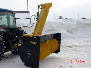

Find below what Reist Industries used to make and mk martin changed their proven designs and well...........................
The image on the left is the Reist Industries 1000 series and the image on the right is the Reist Industries 3000 series. they were designed with utility in mind and by switching out a few parts removing the 3 point hitch plate and adding back an SSQA mounting plate the 1000 and 2000 could be driven by hydraulic motors through the right angle gear box.

I don’t think I have ever seen a single stage blower like those Reist units.
