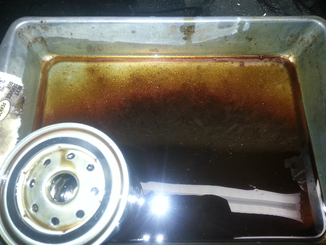

So three days ago we were at the in-laws for Christmas. We drove over our BMW 335I and while out getting some last minute items some A-Hole hit our car and then left in a Hobby Lobby parking lot.
Long story short our car is now in a body shop in Cincinnati. My BIL offered us his 2009 F-150 FX4 with a 5.4L to drive homr so we did not have to rent a car.
Everything was fine for the 120 miles home but backing into the garage I hear some stange sounds. I check the oil and am horrified. Metal. The truck has 68,000 miles on it and I now realize according to the sticker its been 13 months and 18,136 miles since it was last changed.
I drain it and here is what I find. The pan was clean and all them specs are metal. This is just the pan for the filter in the attached pic. The air filter is probably the original and the worst I have ever seen.
I have never taken oil out of a running engine that was this nasty. Remember, I do axpox 100 oil changes per year and have been doing so for about 20 years.
A few hundred dollars in preventative maintenance is now going to cost him a new motor. Maybe $5000. Just stupid.

By the way I plan to cut open the filter in the next few days. I will post a pic.

DP.. man that's alot of metal! I've drained rears adn trannies of old farm tractors and not seenthat many chips!
I'm guessing it wasn't synthetic oil either. had it been.. it might not have been so bad..
yikes.
so.. it's hard to see on te phone.. but are those copper, as in into the bottom layers of the mains and rod shells?

18,000 on the oil why?
That's gonna be a tough call to make especially to someone so naive about vehicles.

The cost of preventative maintenance is cheap compared to the possible alternative.
heck yeah.. he could have done 3 'walmart' oil changes a year for that 18km run ( 6k per ).. for 18-20$ or less a pop with one of those being an air filter included.. IE.. 60$ for 3 oil filters, 1 air filter, and a few 5qt jugs of 5w30 or whatever it drinks... and he'd be 5k$ ahead of the game.. :(
