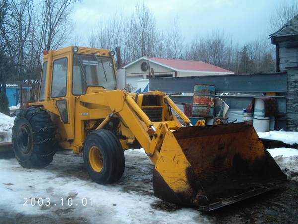

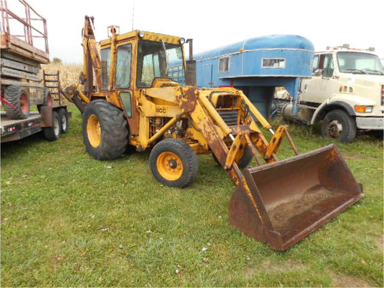

Wider tires have a larger contact area with the ground then a narrow tire. The advantages of a wider tire is that they do not sink as easily, however because they have less pressure per square inch than a narrow tire they also have a tendency to float on the ground and not dig in enough to provide traction to turn the tractor in a tight turn. 78 MF50C BH fr.jpgMF50C Fr.jpg I have attached photos of two MF 50C tractors, the second photo the tractor has larger tires. I have a 2wd tractor with a loader and wish that I had a second set of wider tires because I frequently sink the front end when working in wet ground with a bucket of dirt.
