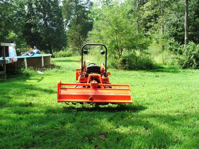

KK 48" tiller on my BX1500 does great.
Put a 5' on one tractor and a 6' one on another tractor and have the best of both worlds.
lots of BX tractors on here with 48'' tillers and 48'' brush hogs and haven't heard any complaints of tractor damage or excess wear from anybody.
I suspect that volume of use has more to do with that than tiller width.
I won't be operating mine 25/8 so hain't concerned with that issue in the least.

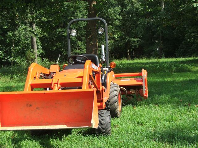

I have a KK 48" tiller on my BX23 and absolutely love it.
For many first pass situations, it's good that the tiller is only 5' wide, but for most 2nd pass or second season situations, a 6' would speed up the operation.
If you take a look at the Implement Limitations section of the BX24 Owner's Manual, it recommends a maximum tiller cutting width of 42" and a maximum tiller weight of 375 lbs.
It is always possible to operate a BX24 beyond those limits; in doing so however, one would normally expect premature wear and repairs.
