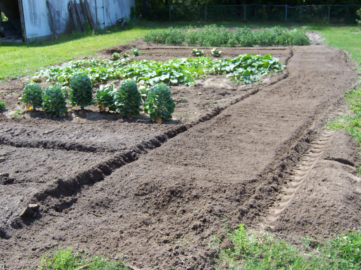

I have a 3510 with a 4' tiller. I run it about 2000rpm (540rpm range) in 1st gear and it pulverizes my soil, it looks like saw dust when done. I use the slow speed because it breaks it up so good. I'm sure that if you choose lower gear it will handle a 6'er with no problems.
The pic is when I first got my tiller.
I can tell you that tillers are worth every penny you pay for them! My garden is so much better since I bought it.
Something to consider, with my 4'er I can go in between a couple rows and replant without disturbing the others that are still growing.
