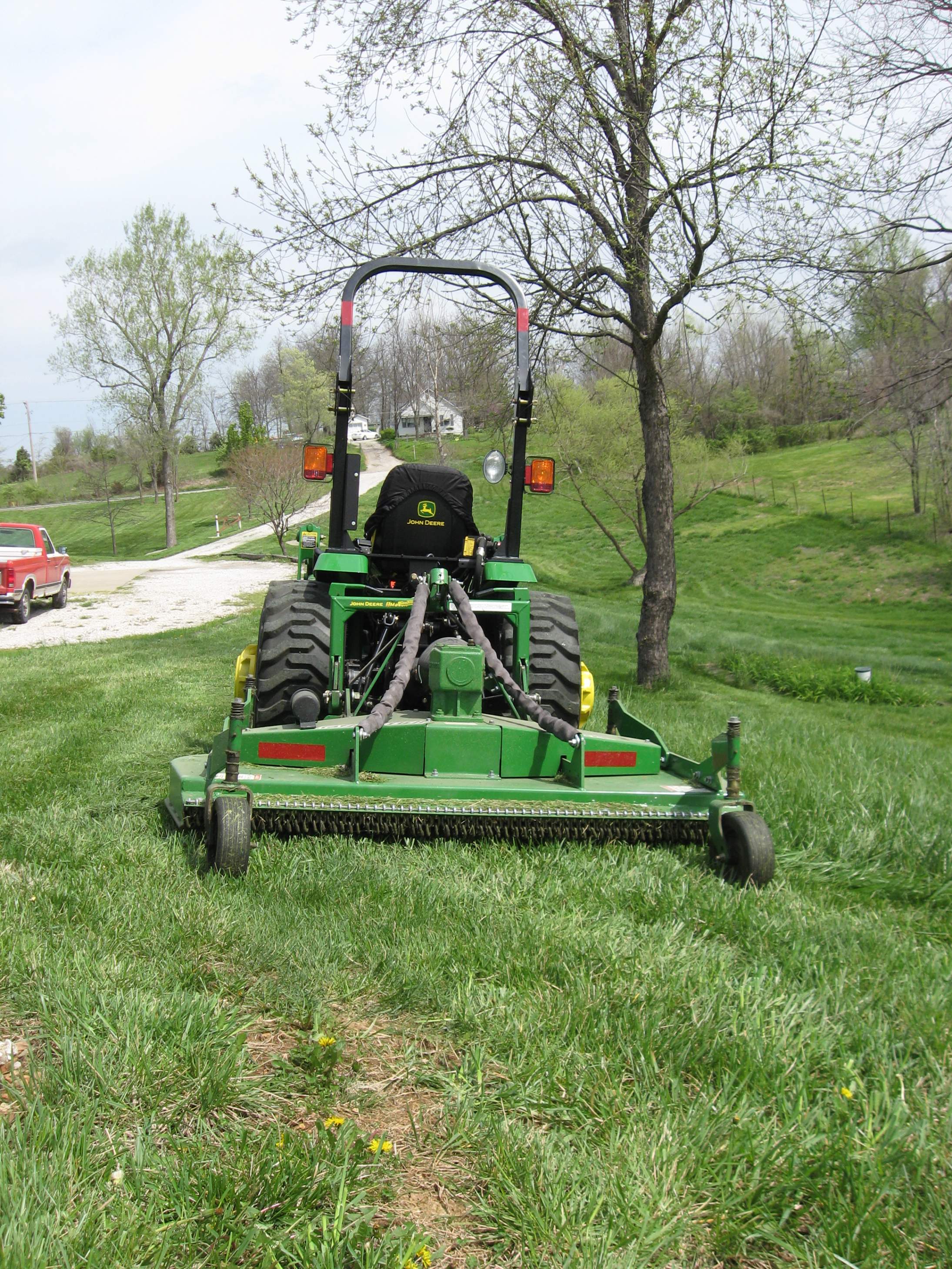

I run a Frontier GM1072R on mine and it has plenty of power for it. This is a heavy mower (675 lbs) and, as mentioned earlier, will tend to drag the rear of the tractor sideways on 20 degree slopes (even with 360 lbs of wheel weights). My property is quite hilly and I need to be in 4WD all the time to use this mower without spinning the tires.
I would have no reservations at all about using it on property that was mostly flat as you describe.
