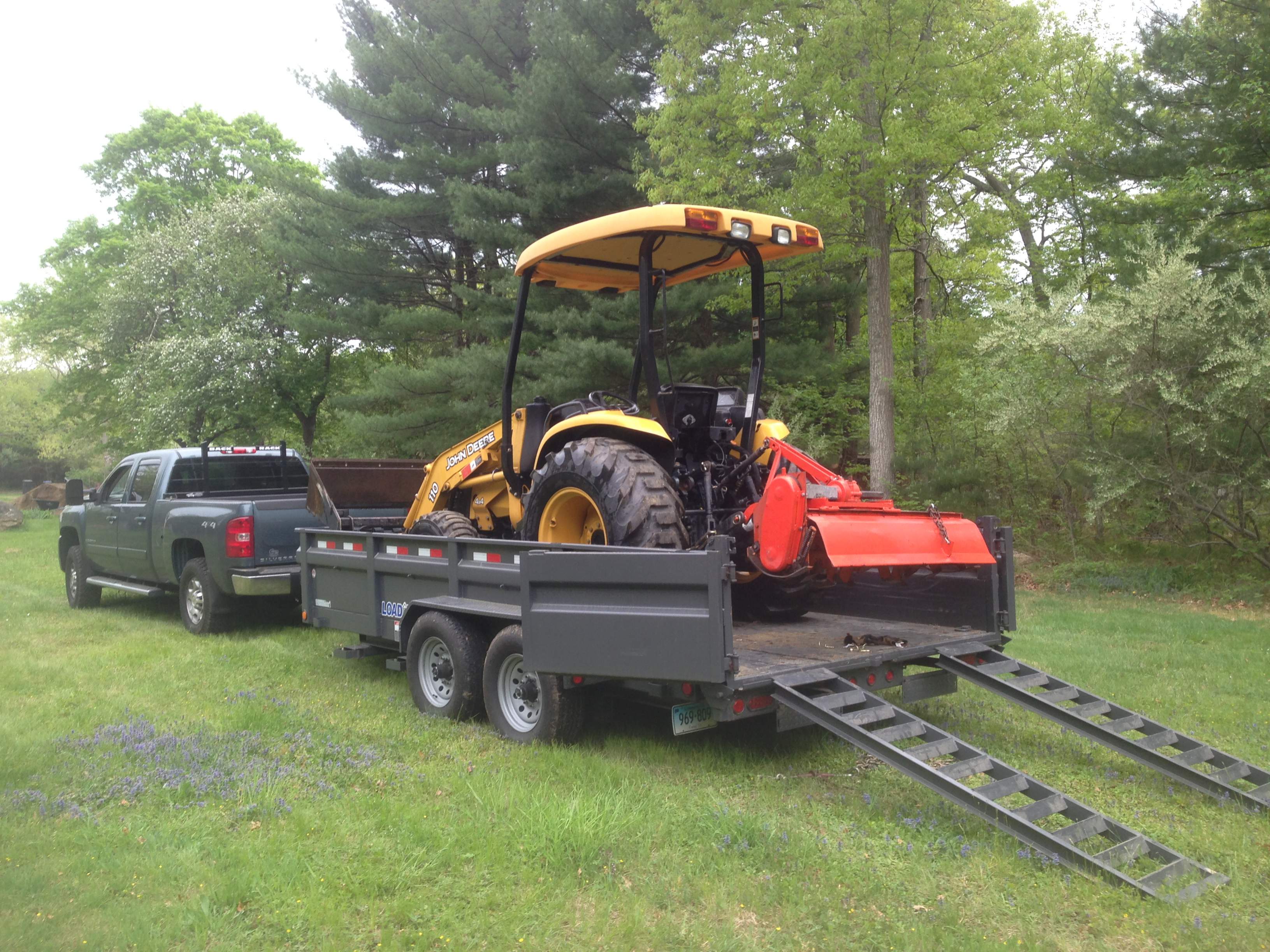

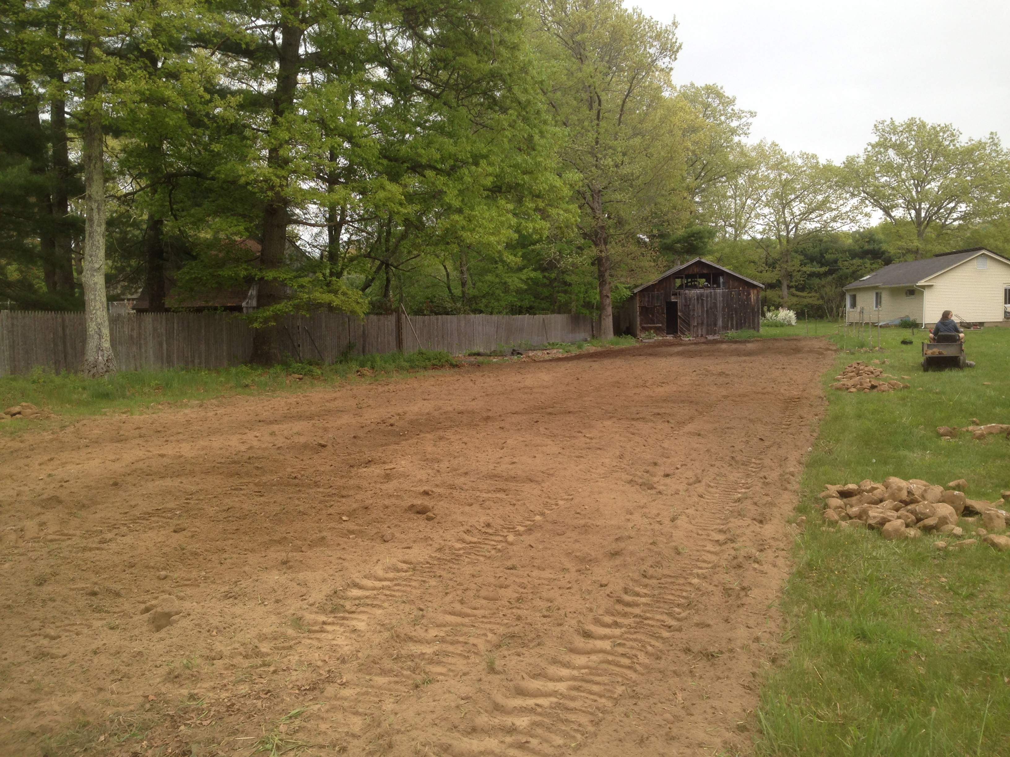

As a fellow New Englander I can relate to this topic in a big way. I've found the tiller will pull round rocks to the surface for picking but shale tends to get stuck. I would use a tiller with a slip clutch over shear pins any day. Here's a few pics of a plot I tilled last weekend, this was virgin grounds and I began by using a scarifier to break up the ground before tilling. As you see there's a few piles of rocks. There were also a few larger ones that the scarifiers pulled up.
It took roughly three passes in opposite direction to get these results. I was running a Befco 50" offset tiller and had the slip clutch smoking a few times.
It will pull the rocks to the surface.
