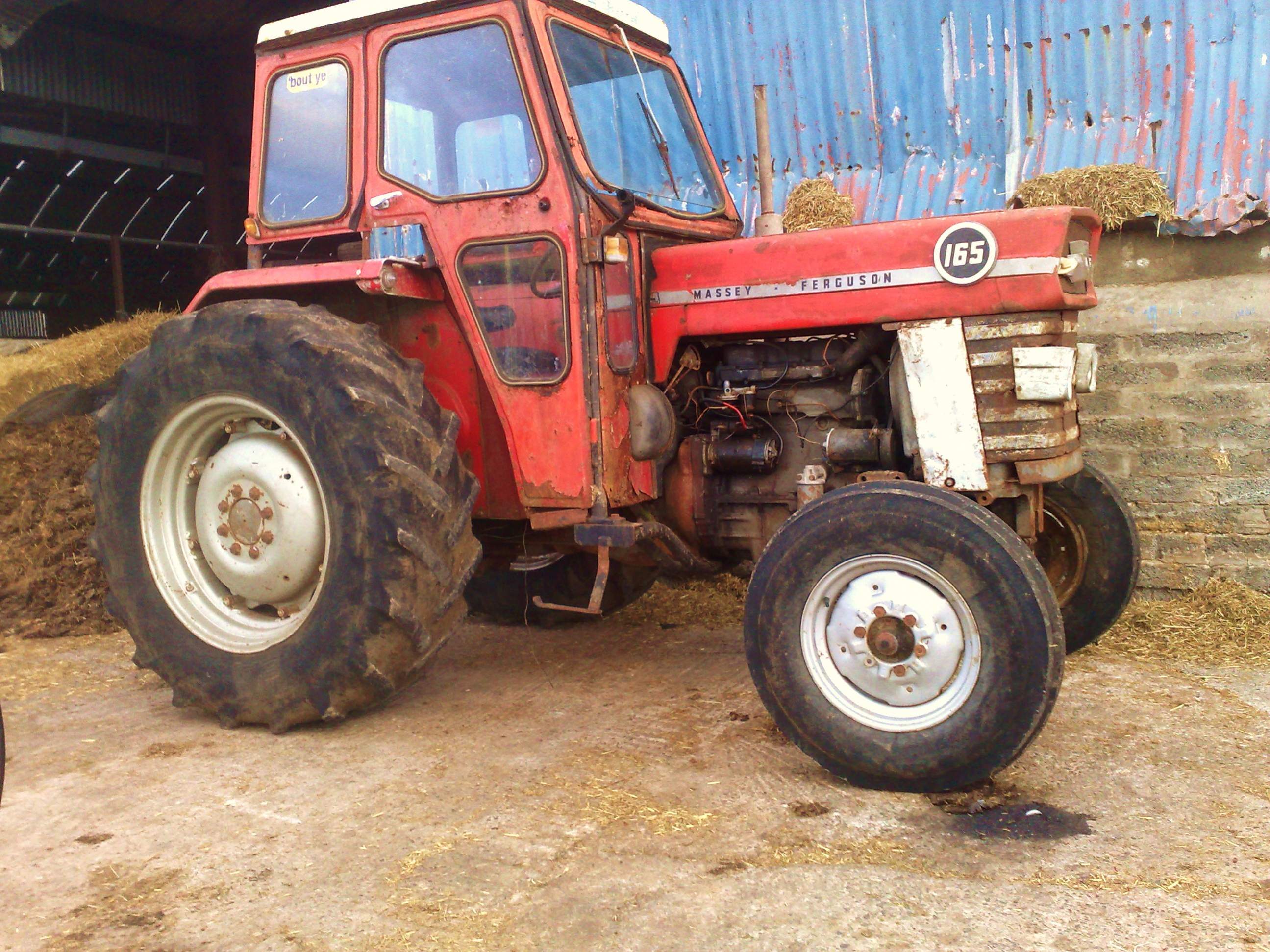

I have 2 Mf 165s, and recently i aquired a MF 40 loader. i was wondering if any one would know what the loader would be fit to lift if it fiited it to the 165.
would it lift a silage bale for instance which averages 800kg upwards.
thanks

The only method I could suggest to is to look up what the loader should lift from manufactures spec. If not that find a model that looks the same as to cylinder diameter and stroke. Next point if it looks like it will fit then attach it. At 800kg or 1800LBs only your pressure and cylinder diameter will determine that. Next point that is a 2 wheel drive tractor. As you put more weight on the front the traction gets worse on the back.
