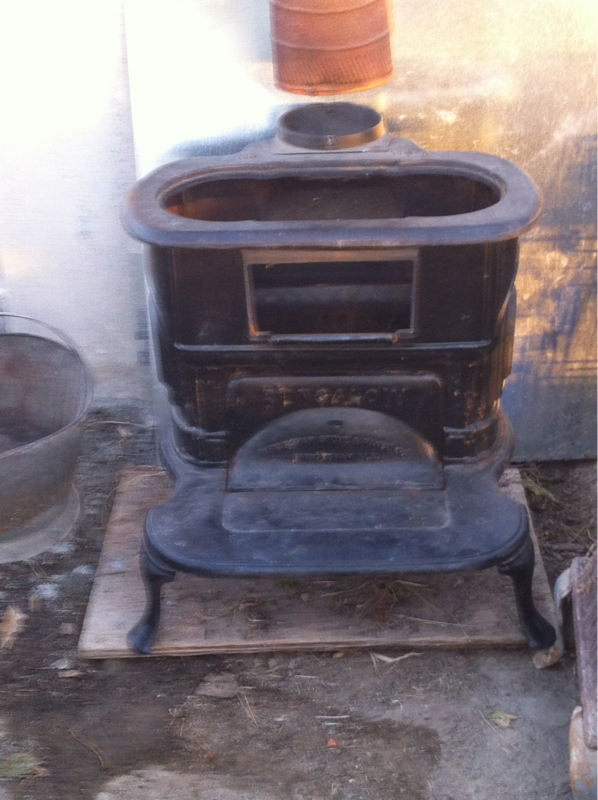

Or too dangerous? I need a better source of heat in my greenhouse. I am considering using this old fireplace insert and convert it into a free standing stove. Of course, I will have to cut away some of my work space, and will have to attach a three wall pipe flue, using a rectangle to round transition piece. Also, I am thinking that some three foot protective walls on three sides would be helpful. Will it work?

   / Will it Work? #6
The dw uses a cabose stove to heat her greenhouse. She starts a fire after sun down and it keeps it warm all night. For the lack of moisture, she puts a pot of water on the stove. It must work we have green peppers and tomatoes all winter.

   / Will it Work?
Yeah, now that's what I want to hear....Just kidding. I do have Propane gas in the greenhouse, but with a 100lb tank. It lasted two seasons, but (1) I was stingy with it (2) I did not know when it was going to run out and (3) I am using an old heater that is not thermostat controlled. I still plan to have it available for the "just a little bit" nights. I have lots of wood, and want to use the insert if it will be safe enough, and not be too much heat for the greenhouse.
Another note: I did not try to use the propane to keep it warm enough for tomato and pepper production. I would if I had wood. And, it would be good to get a thermostat LP heater as a catch all when I forget to fire up the wood.
