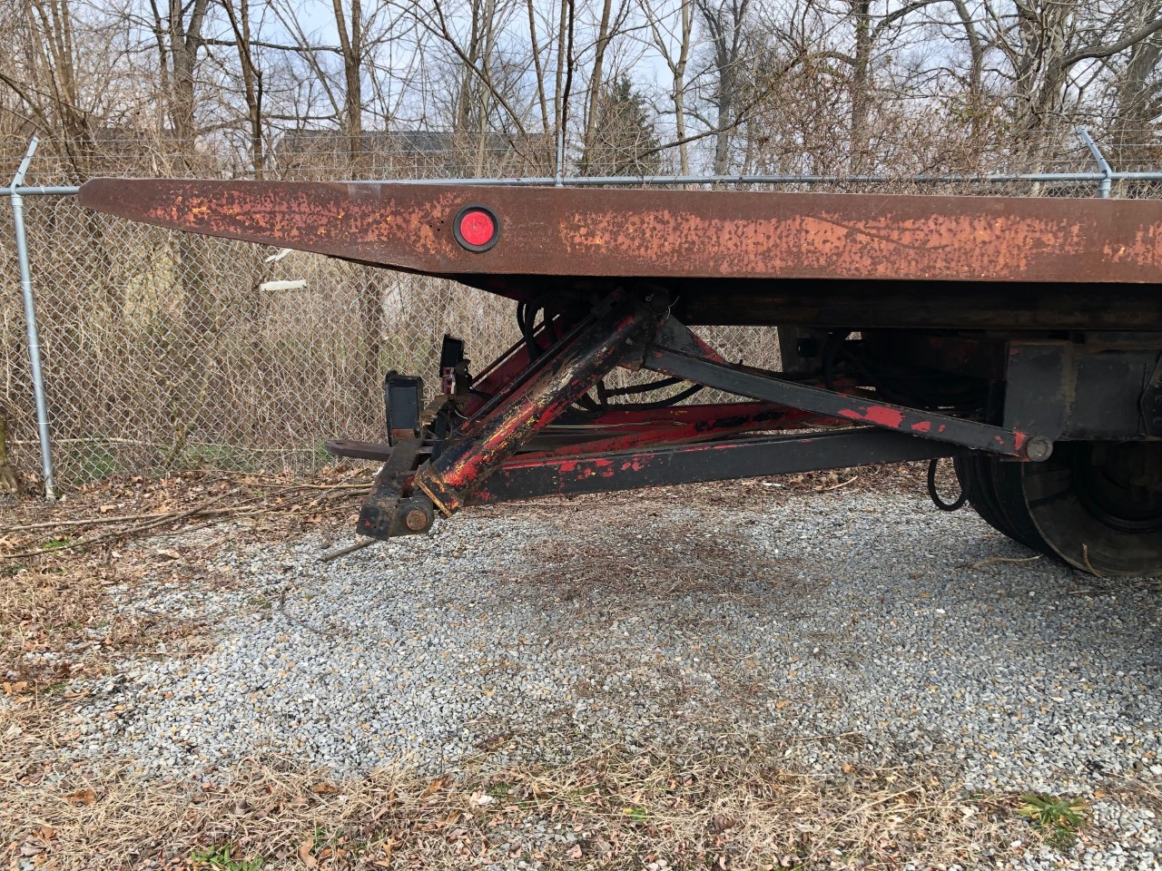

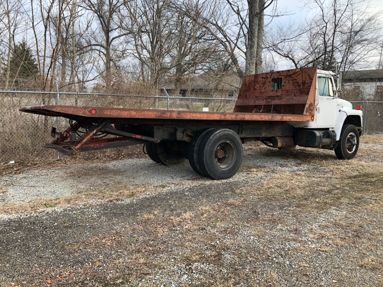

I recently bought an International S1854 with a Grove implement bed. It has a DT466 with a 5+2. Hoping it will be useful as a hobby hauler. I would like to occasionally pull a flatbed car trailer behind it but am not sure if the rear bumper is designed for it.
The Grove bed is different than newer designs and uses the rear stabilizer as the tilt mechanism for the bed. It has 2 hydraulic cylinders and a frame that supports the bed as it slides out, and the cylinders push it up and down.

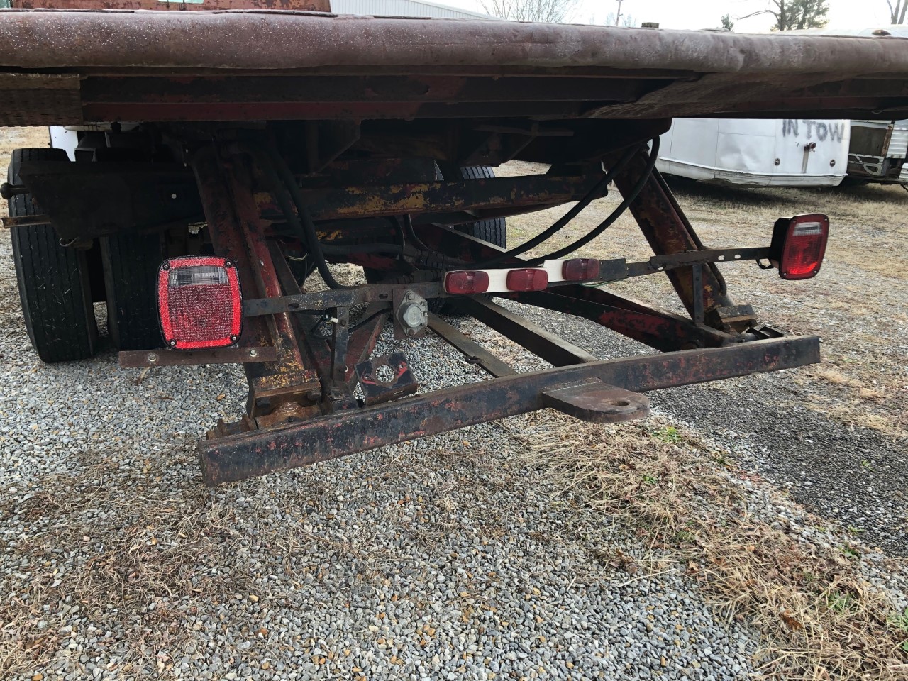

There is a ball mount welded to the bumper bar and 7 pin plug, so I assume previous owners have towed with it. But it seems like there should be something to lock the stabilizer in position.
Isn't a bit risky to rely only on the cylinders to support the tongue weight of a trailer while driving?

I think I might create two short chains to safety tie those cylinder ends up to the bed, to use while towing.

Thats a good idea.
Also might not be a waste of time to find a Grove dealer and ask them if that towing hitch set up is standard for their design. They may have some useful insights. Looks like they may have been bought out by Jerr Dan???

My greatest concern is the weld of the 1/2" plate for the ball. What do you suspect the tongue weight to be as well as the gross weight of the loaded trailer?
   / Will rear bumper on my rollback properly pull a trailer?
I have a 12k 22' flatbed or a 10k 18' car hauler that I'd be pulling. Not looking to go super-heavy with it.
   / Will rear bumper on my rollback properly pull a trailer? #8
Worst case scenario, you could weld some gussets on that 1/2" plate to help keep it together.
The entire frame looks solid for what you're planning to do.
I agree with the chains to prevent it from accidentally going down.
