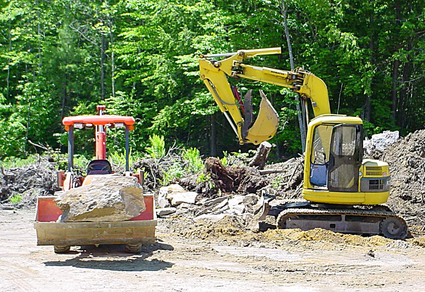

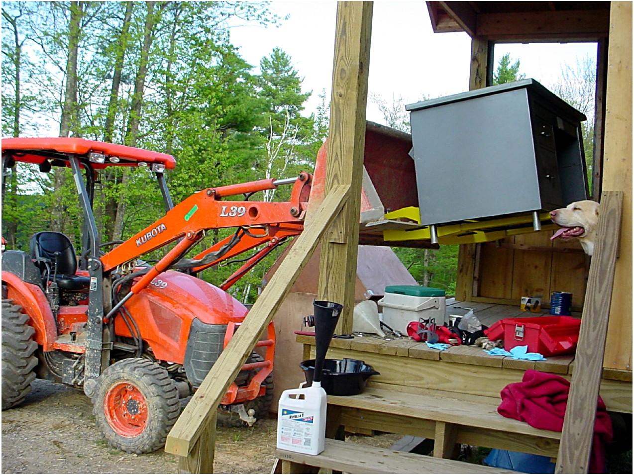

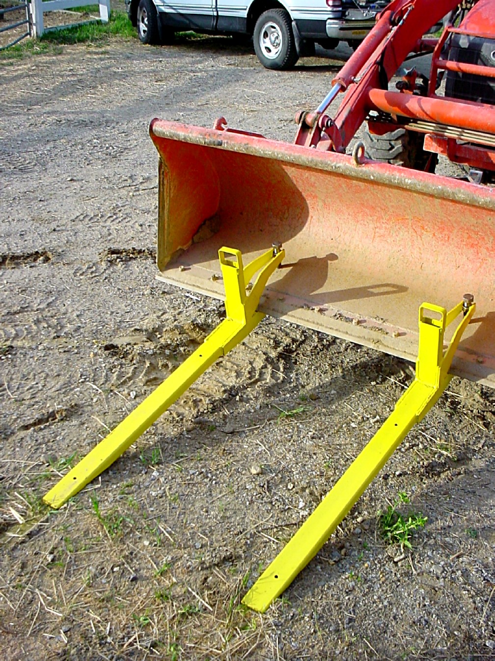

Here is what I found out is the capacity of my L39, with 800 Lbs of wheel weights, my own design pallet forks, and the pressure relief set at 2800 Psig (5% over rated). I also have a small accumulator off the pump to dampen shock loads and have had no problems with pump or hydraulics at 900 hrs.
The max lift about 20" out from the edge of the bucket is 1800 -1850 Lbs. With my bucket forks I can lift maybe 100 Lbs more than the L39 will curl. For safe truck unloading, i.e. lifting 5' I would not want to lift more than 1500-1600 lbs. I figure the L39 could lift 2500 Lbs with a skidsteer fork set-up. The pallet forks are a few hundred lbs lighter than the bucket and the lift point is quite a bit closer to the pins.
I have found factor Kubota pressure setting are 100 -200 psi lower than rated. As delivered my L39 was a weakling. Check your pressure relief and with loaded tires and BH as counter weight.
If you have pallet forks, not bucket forks, lifting 2,700 lbs with the M59 should be no problem, provided the BH is attached and tires are loaded. My wheel weights are absolutely essential for safe operation. Kubota tractors are too light.
Hope that helps, good luck
