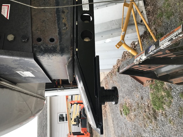

Having a similar problem. Toward the end of the season last year I bought a 1999 Jayco 5th wheel. Old style Leland pinbox. No extender, just points straight down. Barely got it home with a standard Reese 16k hitch. Couldn't turn very sharp at all.
Added a 10 inch pinbox extender. Still doesn't turn as sharp as I'd like. Considered at Pullrite 2700, but their tech guys say the 14 inch slideback is too close to call. They recommend their 2300, which has 18 1/2 inches of slideback. But we're talking about $850 for the 2700 and $1450 for the 2300. And this is using my existing truck bed rails. Plus another $150 for the capture plate for either hitch.
My truck is a 2016 F250 Super Crew. Bed measures approximately 6' 10" from front of bed to tailgate. I'd really rather go with an auto slider, as I don't want to have to jump out of the truck and pull a lever every time I need to let it slide back.
Is the Sidewinder a viable option? We're not camping until Memorial weekend but I'd like to get this resolved now instead of rushing around last minute.

Is the Leland welded on? If so you are very limited, unless you take it to a welder to be modified, but that is a lot of $$$. If bolted on, look for the pinbox model number, and find a pinbox that will replace it. Mine was the Lippert 1716 and those are common.
Looking at etrailer they seem to have some options for you.
We camp with some folks that used to have the Pullrite superglide (they since sold truck and trailer for a motorhome) and that thing made some horrible noises when he wold stop and start in camgrounds. Research says there are adjustments to fix that but his was scary sounding.
The Reese 15K hitch I have is lightweight and easy to remove. I went to this setup from my Anderson Ultimate. The Anderson is solid as a rock and quiet, but not ideal for short bed trucks, in my opinion, unless the nose of your trailer is very contoured. I thought mine was (2015 Open Range Roamer) but nowhere near enough to avoid taking out my rear window.
I contacted Etrailer early this morning. No response yet. It occurs to me that the last time I contacted them I never received a reply either.
As the photo shows, the lower half is bolted on. The upper appears to be welded to the frame. The model number is AF 7900. I appreciate you taking the time to reply here.

I bet SOMEONE makes an adapter to make that like a conventional pin box.
   / Will this be strong enough? #10
Here are a couple of links from Etrailer.
This one shows that it will work with a Leland 7900: What Sidewinders and Replacement Pin Boxes Fit a Leland 79 Pin Box on a 5th Wheel Trailer | etrailer.com
This one has the unit and the price: Sidewinder Fifth Wheel King Pin with Rotating Turret by 5th Airborne, 16K Reese Fifth Wheel King Pin ST4-SW16K
The product link has a formula to calculate clearance. I'm going to throw the hitch in and take some measurements so that I have more information available in the event they reply to me.
It's kinda looking like the Sidewinder might do the trick for me. Will post back when I know more.
