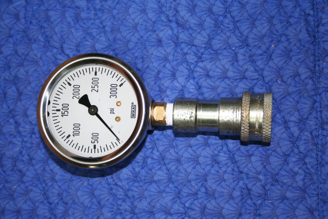

Using a oxy gage on a hyd system is less dangerous, but you really need a 3000 psi liquid filled gage.
Here are two kits that you can make.
The gages are only about $15
